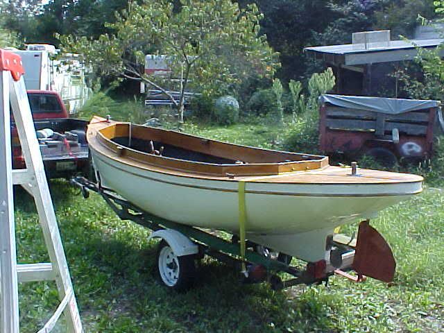

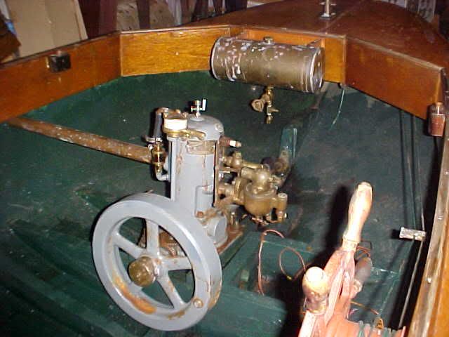

My new launch, Mary Jane, is a Thayer 16’ fantail and at this time she has a 1910 Palmer 2hp engine and a spare engine on a stand. Yes, one of those smelly, noisy, infernal sic combustion engines. That will soon change, anyone want to buy a 2hp
Palmer?
I’ve done a little homework and found that here in Tennessee if my boiler has less than 20ft^2 of heating surface it’s considered a Hobby boiler and requires no certification. Being that my launch only requires 2hp to reach hull speed, my boiler will be smaller than 20ft^2, so I don’t see any more problems with the steam inspector! I think I’m going to build a modified monotube boiler and fire it with propane. A little background, I spent 20 years building ships for Tampa Ship and at one time I was a certified welder. I was also a certified Sulzer diesel mechanic (google Sulzer and click on Images, that’s what I build). I can build or repair most anything mechanical.
As for what engine to use, I don’t know yet, I’m poor and semi-retired now so my engine will be the one I find that I can get inexpensively, I own an antique store and I’m always wheeling and dealing so I never know what’ll turn up next. I’m sure there’s a marine steam engine with reversing gear just waiting out there for me to find it. Anyone want to trade a little steamer for 2 Palmers?
I plan on using Mary Jane on Norris Lake. Norris is a TVA lake here in East Tennessee with about 900 miles of shoreline and a launch ramp is less than a mile down the road. She won’t be the fastest boat on the lake but she’ll be the classiest!
I’ve added a few pictures of Mary Jane as she is now:

That hull looks really pretty and as she had/has a clasic engine I imagine the previous owner cared for her .
I think you could be on the verge of putting a very nice combination together .
All the best of luck with your project .
Regards Edward .

Sometimes I wish I had a smaller boat. Then I could disappear in a cloud of steam and maybe go fishin'!! I think that's a great boat! And--- you didn't hear it from me but that Palmer looks pretty good too! Den
