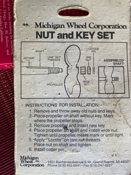

Advice from Michigan Wheel on jam nuts:

Nice to have a fancy conical jam nut...

Post by Lopez Mike » Thu Aug 11, 2022 12:46 am
Conical? I don't get it. But that's nothing new.
