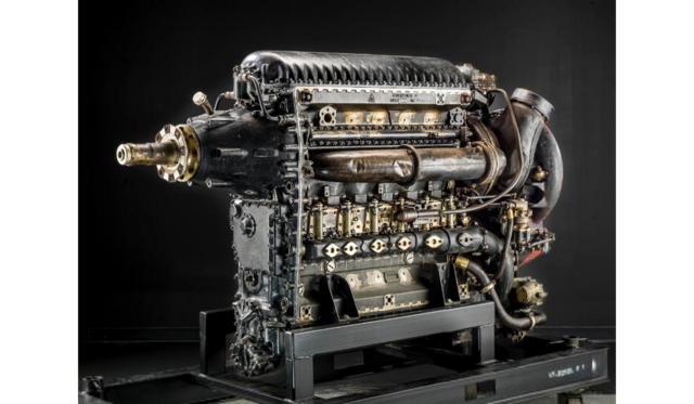

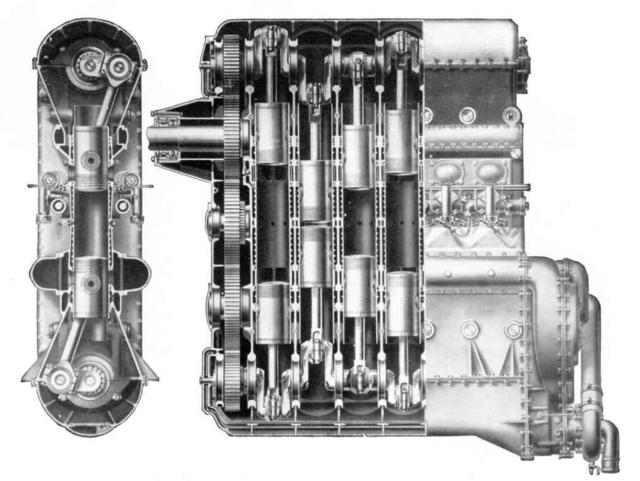

This is actually an airplane engine from Junkers, called Jumo 205 if I remember correctly. This is a very interesting design. It works under the 2-stroke principle with inlet and exhaust ports in the cylinder liner. The thing is, you can find lots of 2-stroke steam engine conversions, that make use of the unchanged ports in the engine. But they are designed for 2-stroke IC engines. So, the people end up with lots of steam pressure wasted through the ports (Yet it is still awesome people build them and they do work after all). This issue can be resolved by changing the location of the ports in a custom-made liner. So far so good. But I was wondering of how it would be able to control the steam engine's power output without throttling the steam. The location of the ports can not be modified (except some sliding liner models like the Knight engine) but here comes the trick: The opposed piston engine uses 2 pistons in one liner. When I saw a gif of an opposed piston engine, that showed, that the 2 pistons don't move entirely synchronized, but one piston moves some degrees ahead of the other to provide for a better efficiency in cylinder filling and exhausting. On to my project:
The points above mean, that in an opposed piston design for a steam engine, each piston actuates/times either the inlet or the exhaust ports in the liner with no need to use any
other valves whatsoever. I foresee one challenge though: The crankshafts need to be coupled by gears of some type and the only way to alter the power output of an engine would be to change the rotational angular alignment of the crankshafts to each other by means of this gear. Technically it is very simple to do, for example via a chain gear. But the point is, that despite the relatively small amount of power used to work the "normal" steam valve gears, this design has to handle the full power of the engine going through the gear. So, the mechanism needs to be very sturdy. I was thinking of a governor, but I don't know it the governor used in this special occasion would swallow too much energy, since it works against all the engine's power. Please let me know if you know of any governor design, that can do the trick. But for a boat engine, that can run under very constant conditions (in comparison to a car engine) I think a manual mechanism could work fine.

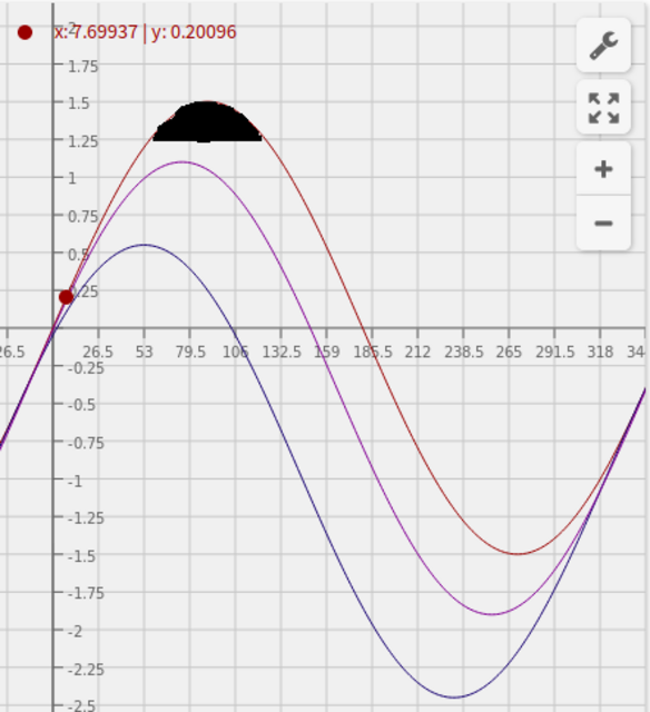

Interestingly, the use of the opposed piston design is like stepping on land where no man has gone before. At least it feels like that. As already for the more common steam engine designs, there had been written lots of amounts about the gears and how to calculate them. But this is new territory. So, I have to create all the formulas from scrap. The power calculation is not that difficult, but some deeply trigonometrical algebra is neccessary to calculate the inlet and exhaust timing.
The positions of the pistons in relation to the angle of the crank need to be expressed with 2 sinus curves and those functions need to be solved to calculate the timing.

The first step I take to design a steam engine is to check the steam distribution. Especially this project needs to get some crucial calculations done to see HOW the engine can be realized. Thus, I needed to create functions to describe the piston travel over time. I found by sheer luck, that there are even websites, where someone can write functions and it spits out the graphs. So, after creating the functions, I tested them:
Imagebild im internet hochladen
The two pistons travel up and down inside the cylinder, creating approximate sinus curves. There are 3 graphs. The highest defines the movement of the upper piston and the two lower show two cases for the lower piston movement. The Y-axis is to be read in centimeters. The crankshafts have an approximate stroke of 3cm, so the amplitude of all graphs are the same.
My aim was to keep 10% intake in mind. So, the black colored arch at the top would define the intake port opening over time. Very soon, it became clear there is a significant drawback for the steam distribution with piston-controlled inlet ports:
If the crankshafts are geared together to produce the middle graph, the lower piston roughly reaches the inlet port while remaining as close to the upper piston as possible before it reaches TDC (even this can not be achieved satisfactorily). But even before the intake ports are closed by the upper piston again, the distance between the pistons don't change much anymore. An opposed piston engine can only produce power while both pistons move away from each other. For a good expansion ratio, the angular difference between the cranks has to be relatively small. But this means there won't be any way to produce significant power.
I tried to solve this by increasing the angular difference between the cranks, represented by the lowest graph. The space between the pistons change much more in this case, providing the possibility to create an opportunity to expand the steam. But now, the steam is wasted. When the port opens (represented by the blackened area in the highest graph), the lowest graph/lower piston just reaches its top. An approximately perfect condition. But the distance of the lower piston to the intake port is ridiculously big. One third of the stroke is filled with full pressure steam and then, the steam gets shoved to the bottom end of the cylinder without any significant change of the displacement space before the outlet ports open. I could have experimented around some more with other configurations, but these cases already showed the design's shortcomings.
All in all, using pistons to control the intake port in an opposed piston steam engine is definitely doable, but not practical.
So, my project needs to be developed further. It is a learning project and learn I will. To overcome the inlet timing issue, I decided to add inlet valves. Either Briggs & Stratton poppet valves or maybe rotational valves. Since there are no cylinder heads to host the valves, I think about a sort of inlet register at one side of the cylinders driven by a chain or some gears. This way, I don't have to worry about the governor, since now, the governor only has to overcome the friction & spring-load of the valve drive. Using inlet valves, the pistons can be made moving simultaneously, providing a smoother run.

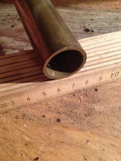

Before the crankshafts arrive, I have to decide what kind of steam distribution I am going to realize. Briggs & Stratton or self-turned poppet valves or a radial piston valve.
Poppet valves have by nature little friction due to the non-sliding, but lifting opening. I know IC engine valves move very easily in their precision reamed valve stems and while the springs are very strong, they give off the spring load, that they swallow to be compressed. But to design and machine a proper cam is something I have respect of.
On the other hand, a rotating tubular valve is very easy to machine. But the rotation would create constant sliding friction.
This is a brass tube I have lying around. It would have the perfect size. But I am not sure what material pairing I'd use for the rotational valve. I thought about buying a PTFE tube, that would fit inside, because I will not mix the steam with lubrication. That is what the crankcases will be for.
Added: I just realized PTFE is said to be heat resistant to 370°C. Considering my lack of experience with the efficiency of superheaters, I prefer to have more safety distance towards the maximum temperatures the materials can handle.
