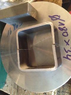

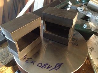

I am currently fidling with different pieces of steel trying to figure out a way to attach the bearing end plates to the crank case tunnel. Does anyone have a good idea to do so?
This is what I originally intended:
(The piece of metal I used as the table is going to be the flange for the lathe.)
These U-shaped profiles were forming the crankcase.
In the second picture, you can see the blocks for the ball bearings closing off the crankcase ends.
And then, they would be bolted together with holes to be drilled through the bearing blocks, creating the entire crankcase like this:
Maybe I over-engineer the engine too much and I just could go the way I showed here at that size. Maybe the split bearing end plates wouldn't be perfectly tight considering the ball bearings and simmer rings sitting in the middle of the 2-piece end plates. But maybe this wouldn't even be of such a concern with a little Loctite. I don't know. But at least this part of the engine is very easy to modify.
Ugh, I'm shifting from one solution to the other. The 1-piece end plate would need something like a flange welded to the crankcase to bolt the end plates onto its ends.The redneck fix would be to just use long bolts reaching from one end plate to the other one and tighten the nuts with the crankcase held in between like in a vice (someting to keep it at least sufficiently alligned would still be neccessary). Thought this is too redneck for me. It just wouldn't look good.
