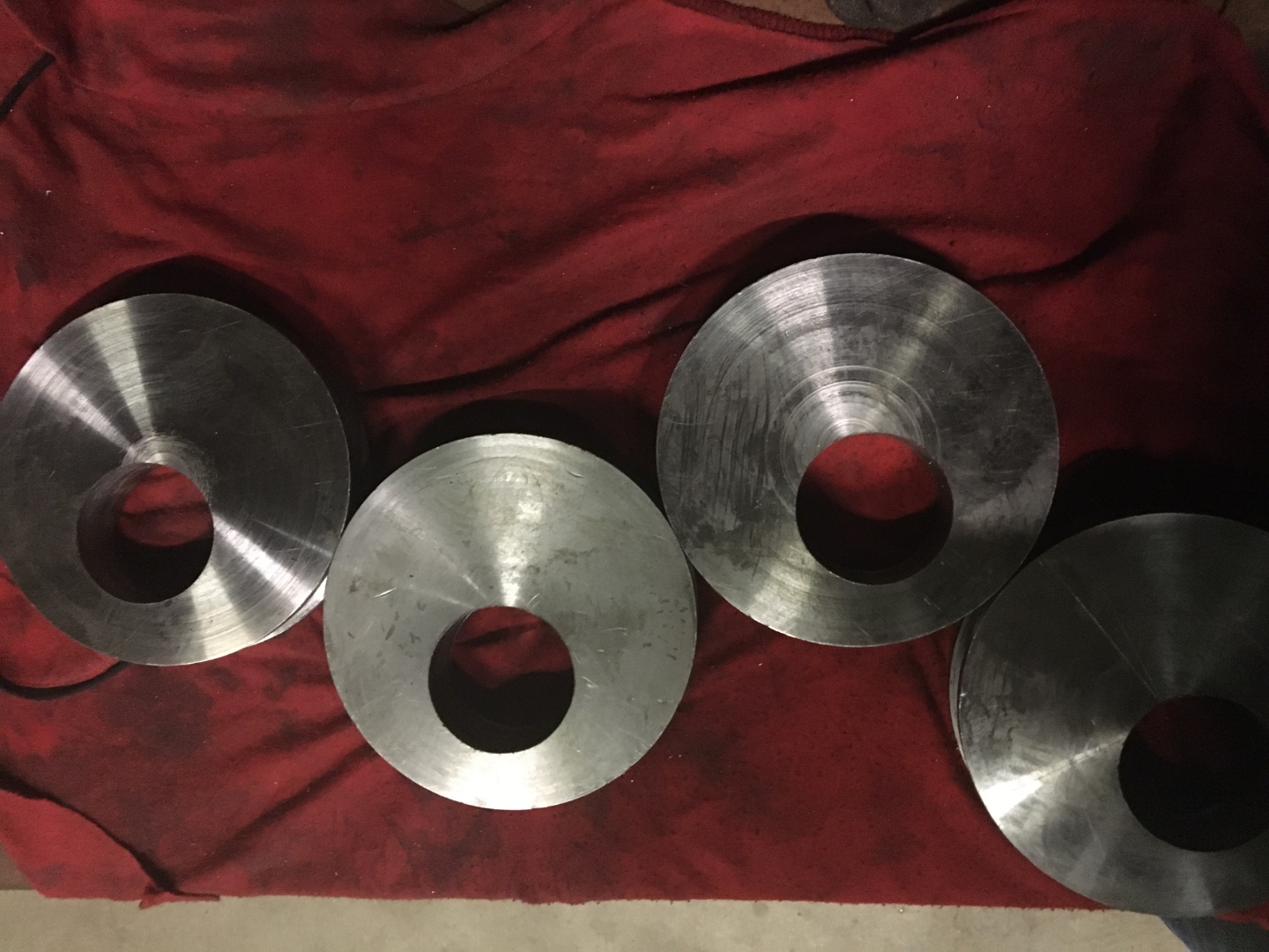

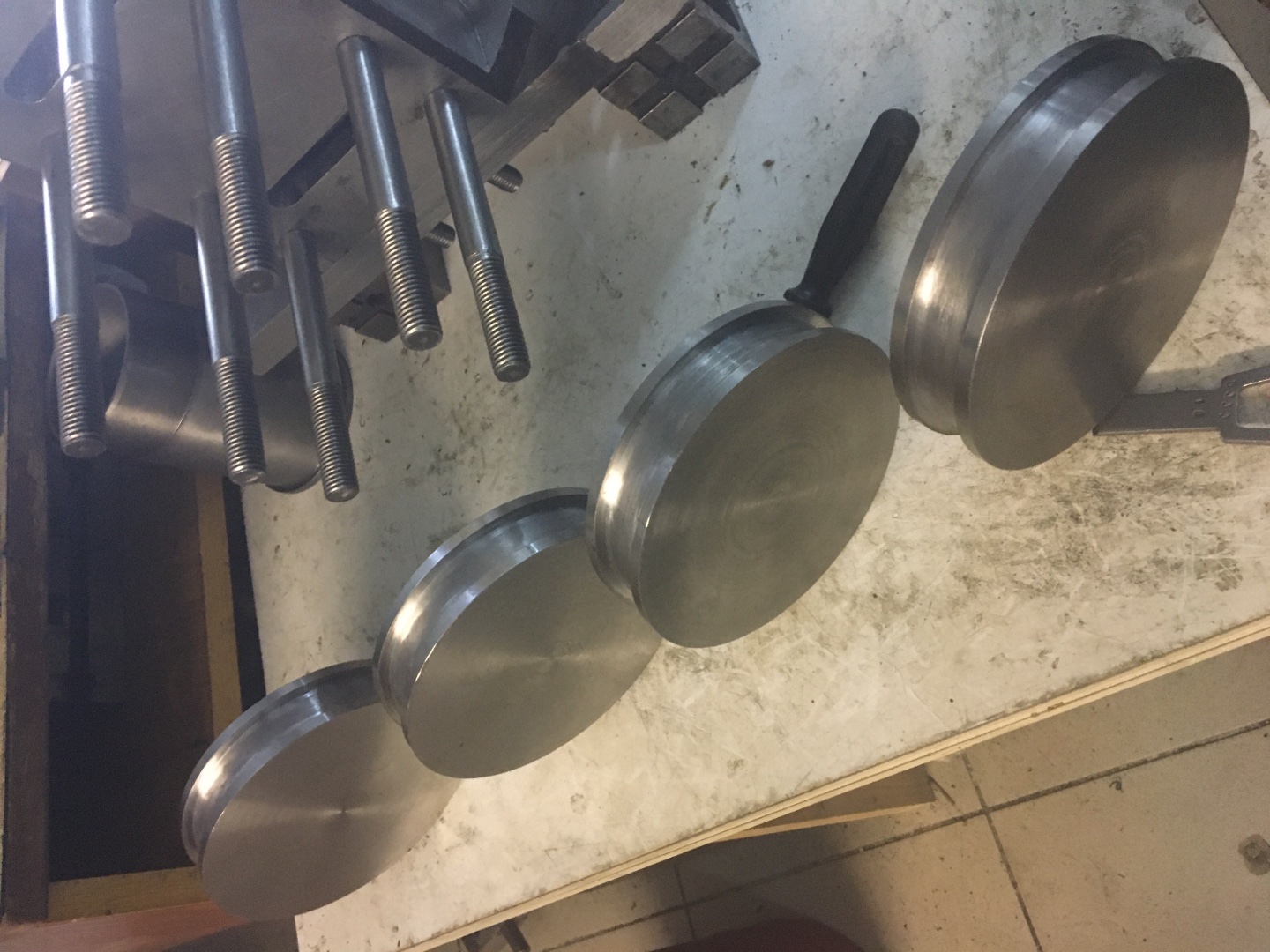

Dear PeteThePen, Lopez Mike, RNoe, TahoeSteam, DetroiTug and all forum members who supported me with their advices and kind attitude, I am glad to welcome you! For various reasons, the progress of my project slowed down a lot, but did not stop at all. In our "southern latitudes" the temperature on some days dropped to -16-18 degrees Celsius, at nights to -25 degrees Celsius. Snow fell as much as it usually happens in Siberia. But in my workshop, I continued making eccentrics. Here is a photo:

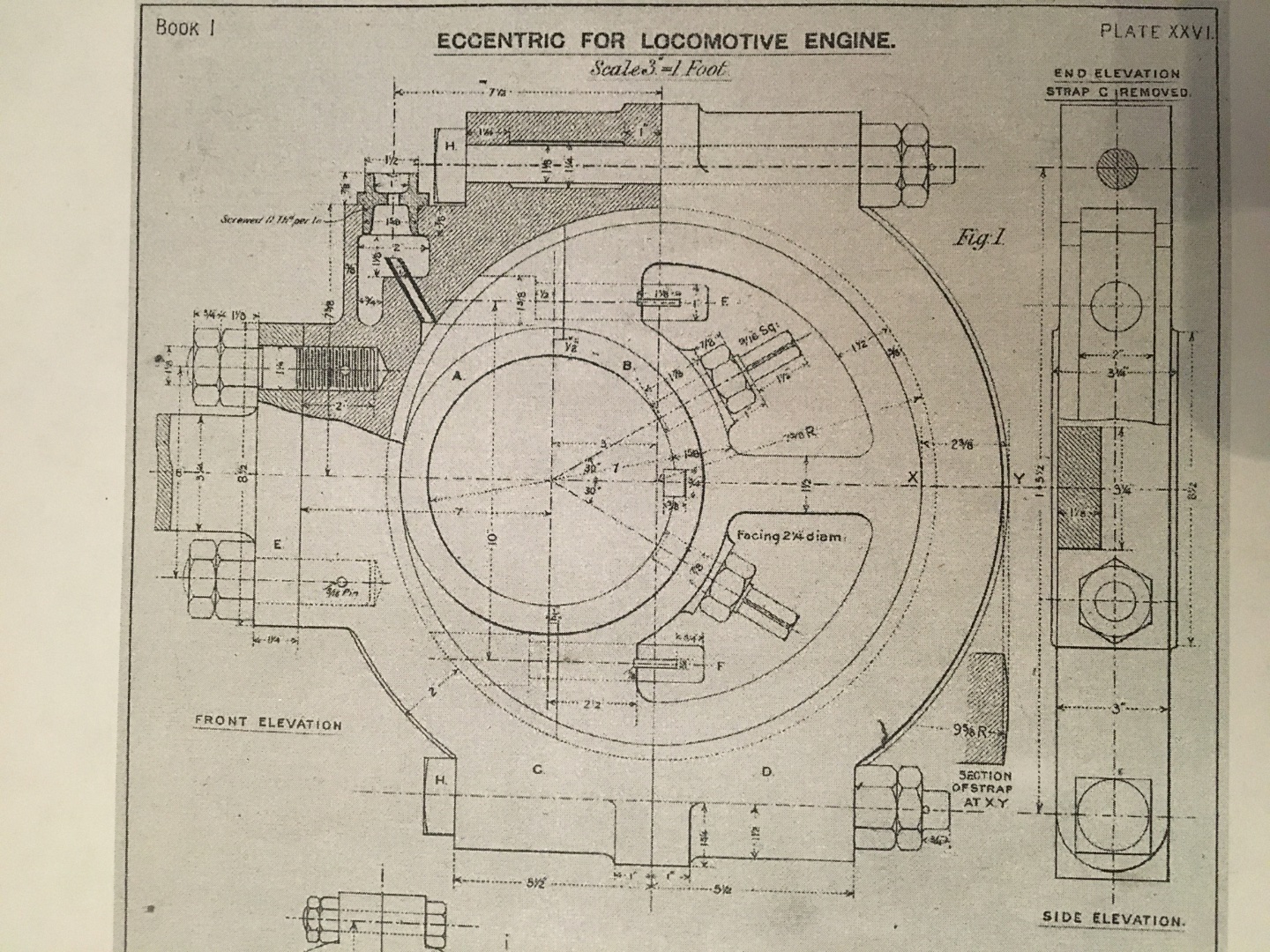

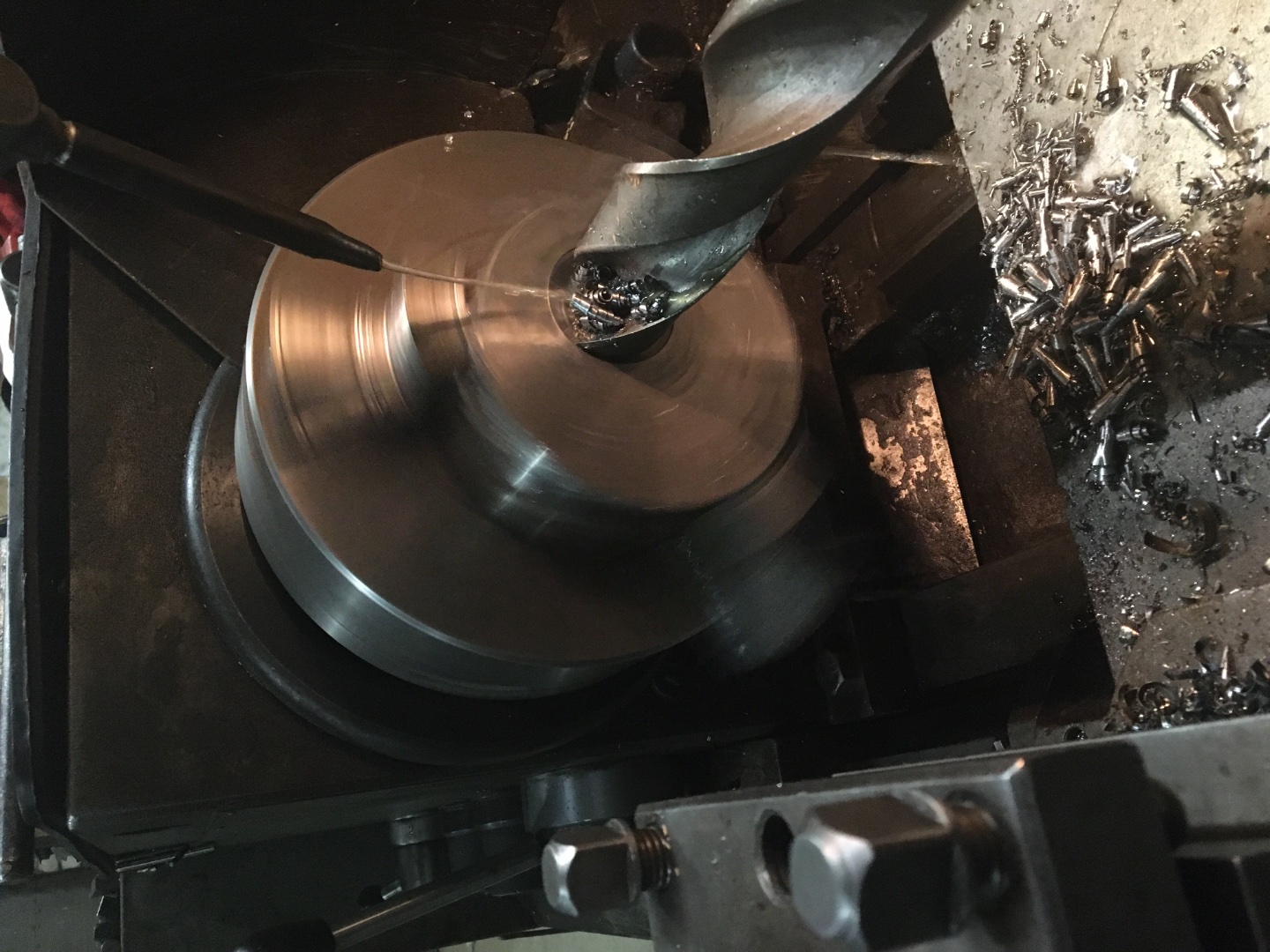

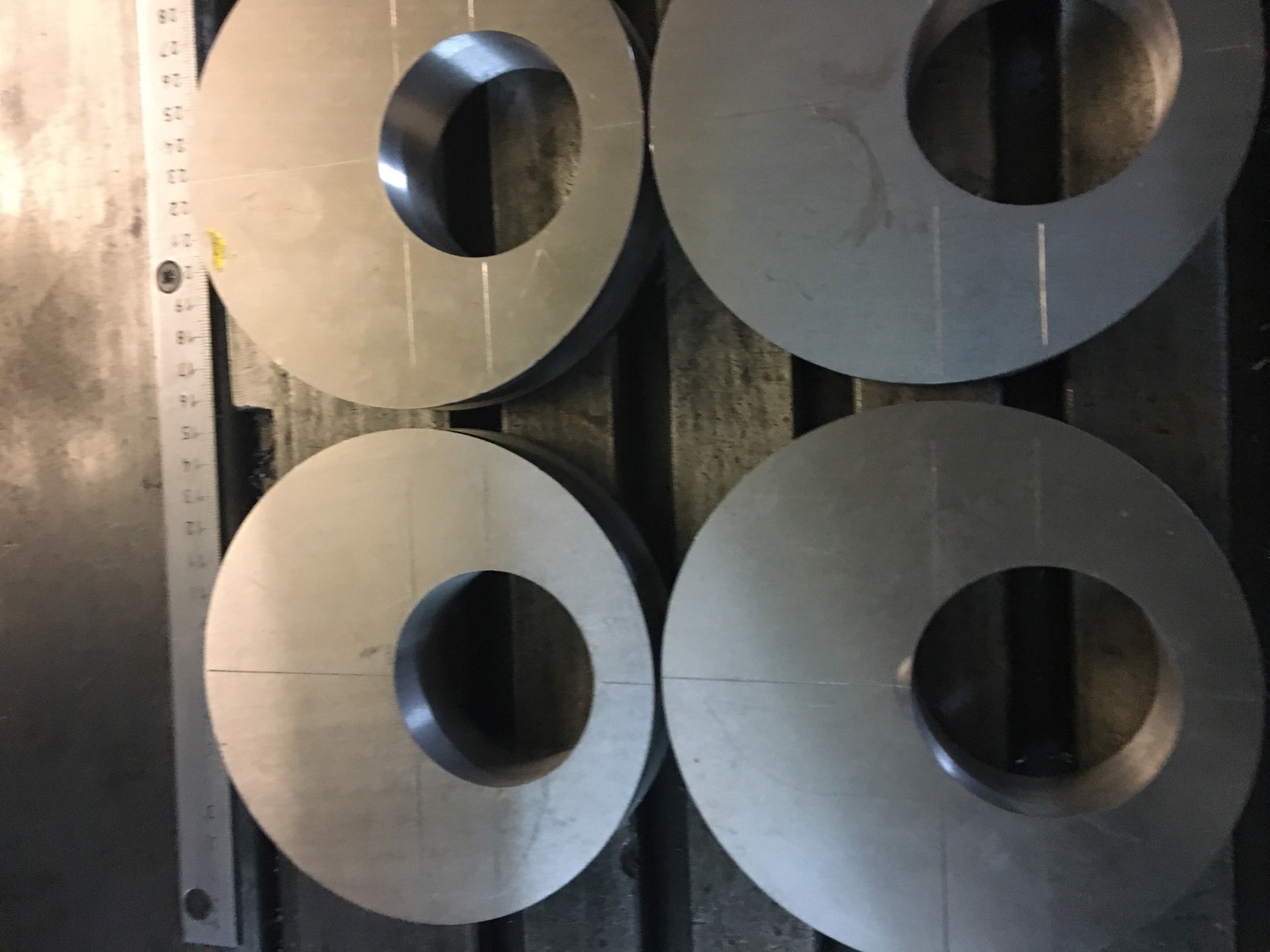

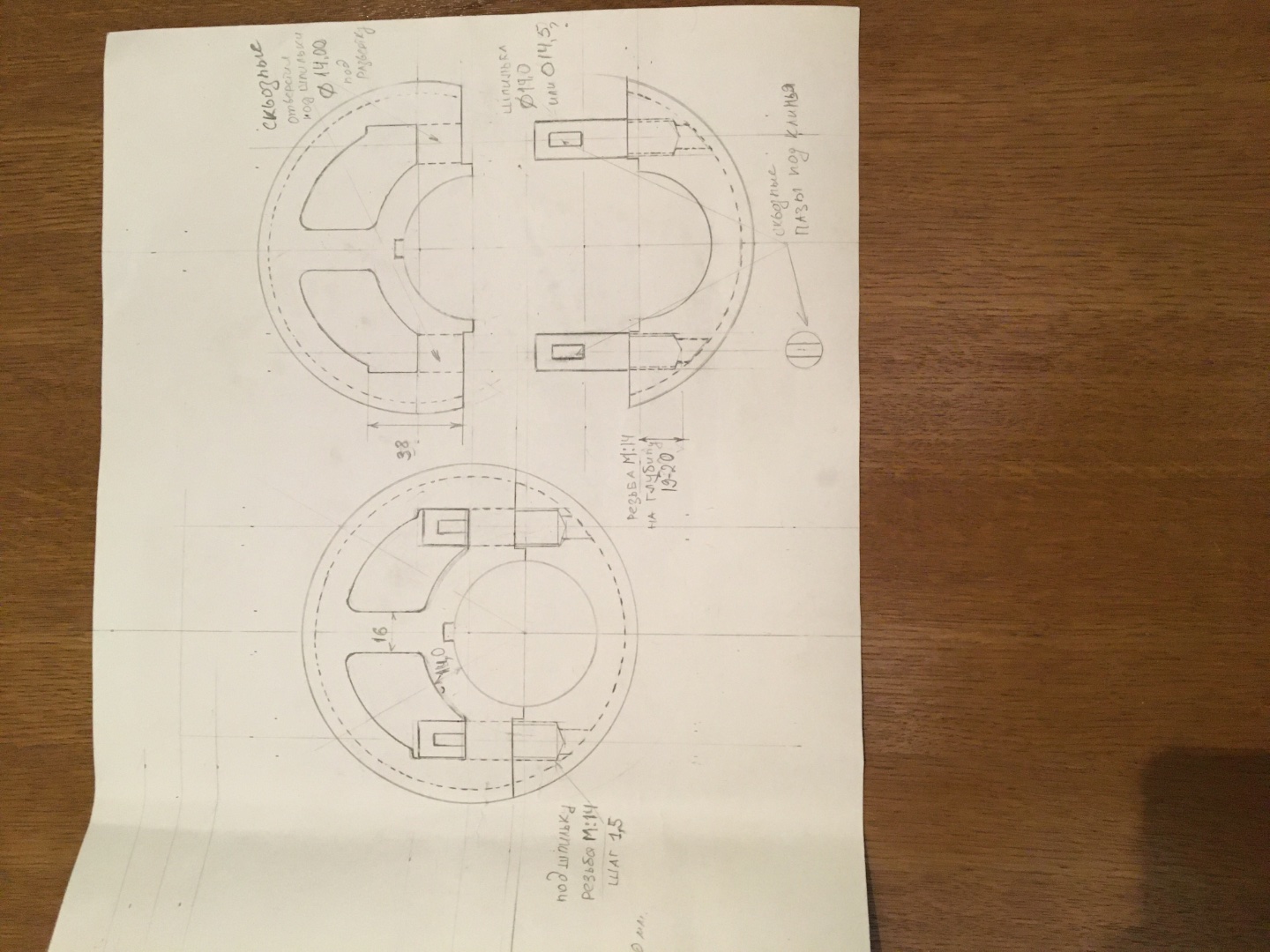

I would like to say a few words about the construction of eccentrics. The diameter of each is 120 mm. plus flange and overall diameter - 131 mm. Thickness -29.75 mm. Eccentric offset - 21.7 mm. The total travel of the eccentric is 43.4 mm. I would like to achieve full compliance with the design of eccentrics on steam engines of the late 19th century. I am attaching photos and drawings. I do not know if this design of eccentrics will be correct on my steam engine and how it will all work. On the forum, I have not seen detailed photos or drawings of eccentrics that are used on your steam engines. I hope for the recommendations and advice of the forum participants. Best regards, Ingvar.
Very good work as usual.
You had me puzzled for a minute boring an offset diameter in the three jaw chuck. Then I realized one jaw was skipped a tooth out on the scroll, very clever.
Ron
As a side note, these can be successfully made from bronze shaft. My steam car has them and they have serviced very well.
Ron

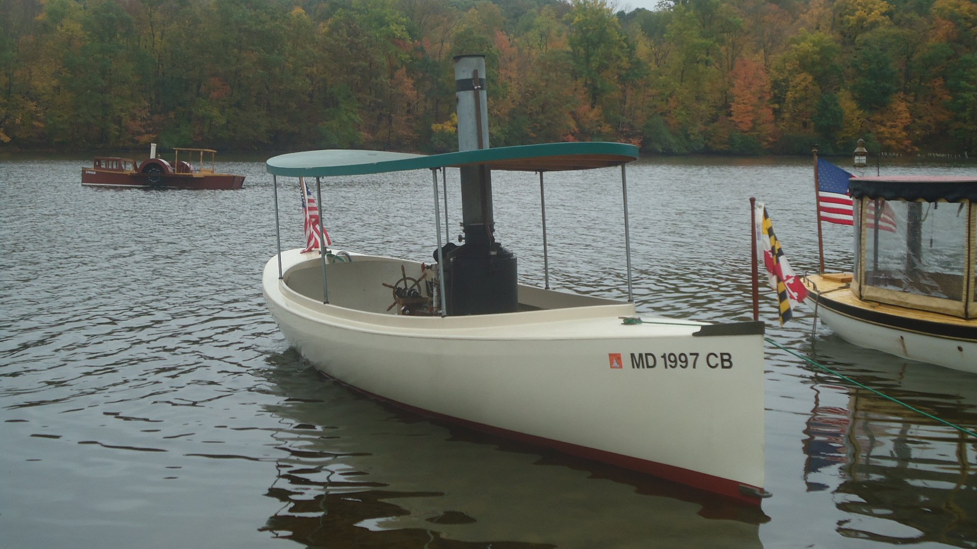

The Phoebe, to the right Galatea, and the Margaret S under way.

I've just done something very similar, and completely unintentionally. I set a piece in the chuck and thought "that doesn't look too true!" When I checked I'd transposed jaws 2 and 3!DetroiTug wrote: ↑Mon Feb 22, 2021 8:51 pmVery good work as usual.
Ron
