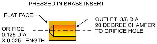

Attached drawings of a typical test orifice for small launch boilers, made by pressing a brass insert into a small pipe nipple. Orifice size should ideally be reamed, and it is important to NOT break or chamfer the sharp inlet edge in any way. This orifice will have a discharge coefficient close to 0.6
This orifice would be better in stainless steel, but more difficult to machine.
- ORIFICE NIPPLE.jpg (13.67 KiB) Viewed 114136 times
- ORIFICE INSERT.jpg (13.89 KiB) Viewed 114136 times

Orifice bore length could be much less than 20% of the bore, but for ease of machining the 20% ratio (0.025 on a 1/8 inch orifice) is easier, and the discharge coefficient is still close to 0.6
