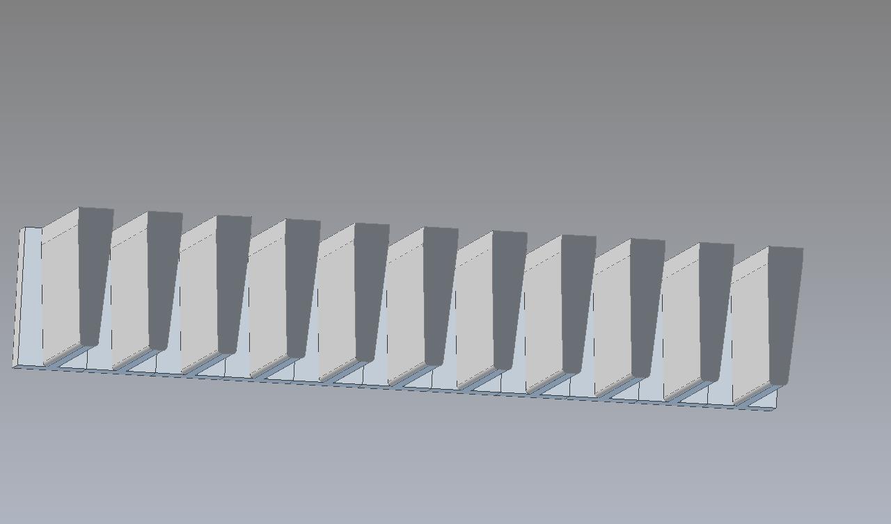

for the modern DR (Deutsche Reichsbahn)-Locos is the free grate area 40 - 42 % of total grate area. The air gaps are 14 mm wide and the crowns of the rod also. The sides of the rods should have 4 degrees.Is there a common ratio that is used to calculate the vent areas for below grate and above grate relative to a given grate area?
Hope it is helpful.
- Grate for the coalfired boiler for my steam loco.
The rods are 2 mm wide and 8 mm high. - Rost0208_kplt.jpg (42.69 KiB) Viewed 18918 times
