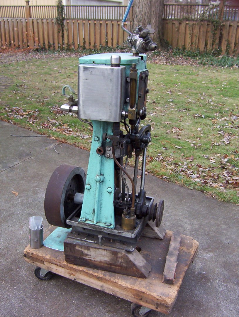

It appears to me that this fine little engine is equipped with a sump pump (lower right) that discharges into the stainless oil reservoir up top.
