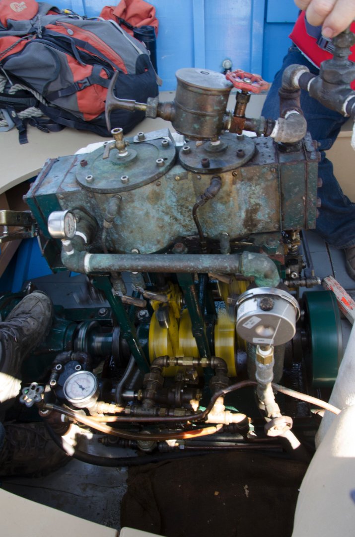

Sintered bronze works very well indeed, and is forgiving of a momentary loss of lubrication, which the solid bronze alloys are not, often scoring the journal if left to continue. A friend has had very good luck on his powerful steeple compound with bronze bearing shells with a thin layer of tin babbit, machined to fit precisely in both the bedplate (which was line bored for the shells) and the hard-chromed crank. Since it's a steeple, these are not split bearings, although that should not matter if the split halves register properly. The nice part is that since these are machined to fit, he was able to make an extra pair should they ever be needed.
Plastic materials work very well indeed in areas w/ low PV; in valve gear bushings they're ideal, and do much to hold down any noise. I've not tried the really high-tech (e.g. expensive) plastics, though.
Rainbow's compound engine came fitted with roller bearings; I've not had the bottom end apart, but the word is that it's quite difficult to reassemble properly. I think the AVL engine has needle rollers; if I remember correctly the crank is in two parts (each half D-shaped) at the center journal, held together with the inner needle roller race.
Plain bearings have the advantage of being much more tolerant of dirt and salt water; on some headings a cross sea + wind can send salt spray onto Rainbow's engine. Lots of lube before, during and after steaming is needed.
An engine made largely from nickle aluminum bronze would be ideal for salt water.
Rainbow's engine:
