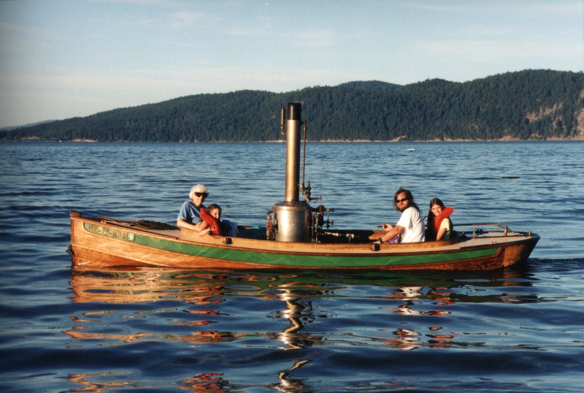

As far as planning goes, I'd work backwards from your boat's displacement to pick a suitable engine design. Typical steam powering levels are 1-3 hp/ton of boat displacement, with 1 hp/ton being slow, and 3 hp/ton being at the "sporty" end of things. Where do you plan on operating your boat?
Here's a photo of our boat "Otter" nearly 20 years ago taken in the San Juan Islands in WA:

To avoid "furiousness" in routine operation, I would power such a boat around 50% higher. Or more! One of the pleasant aspects of a steam launch is the sense of not working that hard. No thrashing about whenever you espy another steam boat. Most unseemly. Fred's boat is a great example of stately progress though the water.
