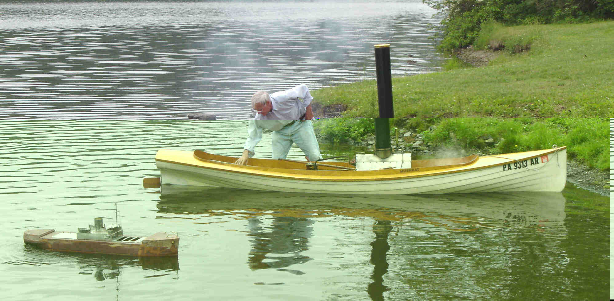

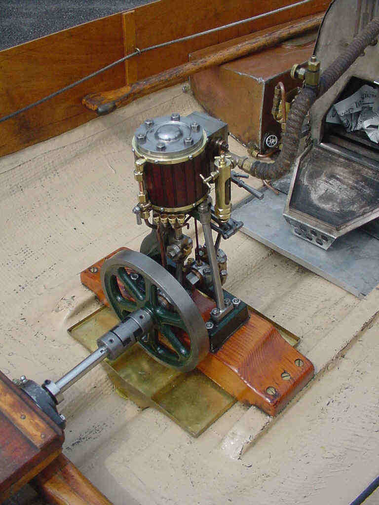

The steam coaster with Saito two cylinder engine. Next is Muskrat, a Wineglass Wherry, 12 foot long fiberglass boat with a Stuart No 1 engine. This boat, about twice the displacement you are contemplating, gets along very well with the Stuart No 1 engine.

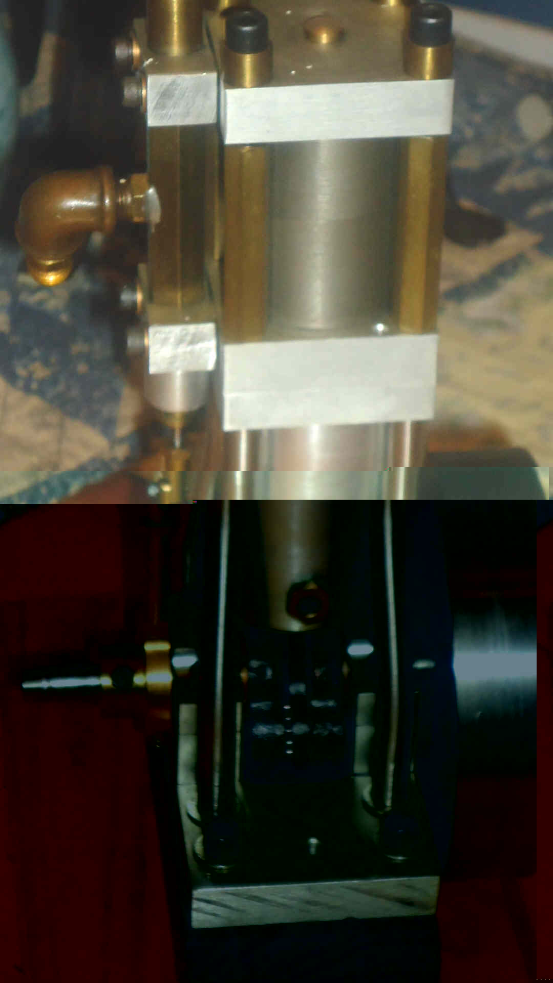

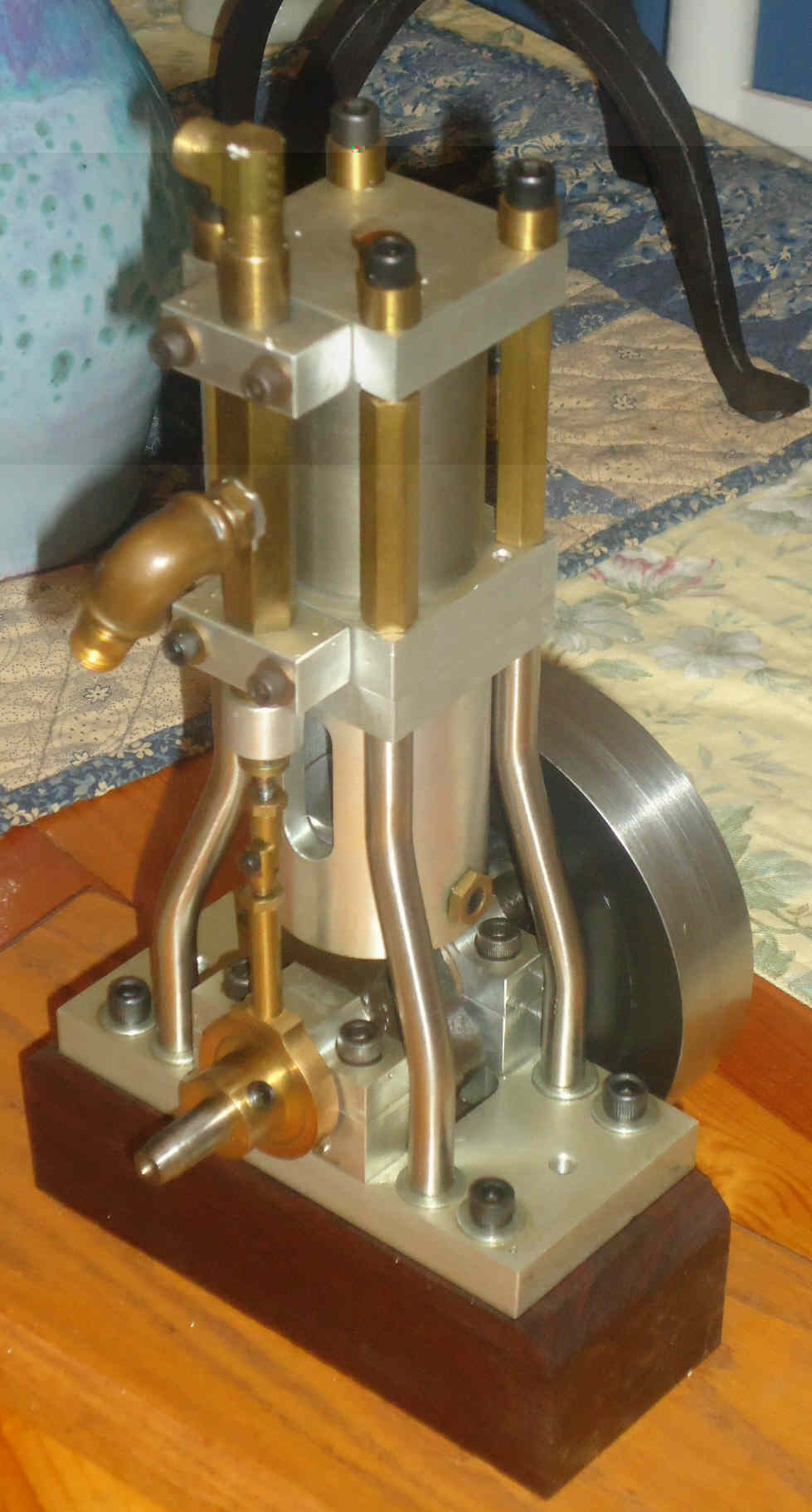

I built a small double acting vertical engine fron castings, similar to a Stuart V10, single cylinder. The build/machining process is described here: http://www.classicsteamengineering.com/ ... 677#msg677
Hope you might find some of this interesting.
