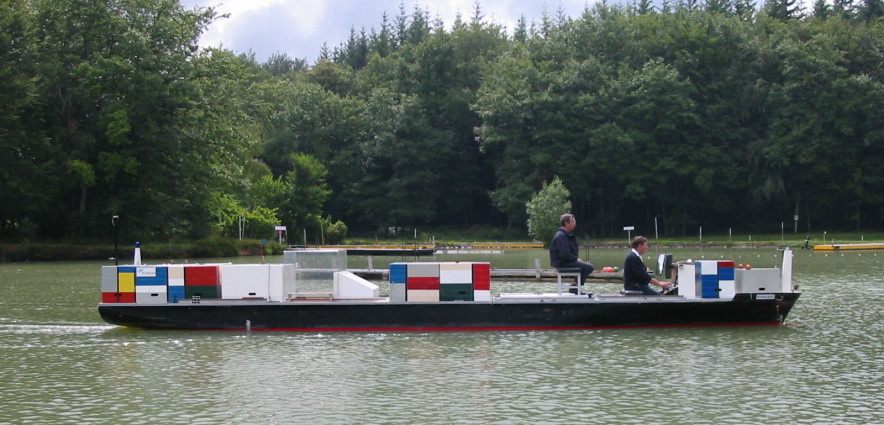

In fact, a displacement hull form (as defined by her lines drawing) can indeed be "scaled". That is exactly what is done at numerous marine design testing tanks, a scale model is towed in the tank to determine hull character, with proper scaling functions. These model hulls are scaled with a ratio (model dimensions/prototype dimensions) of far less than 30% presented on the first post within this subject. Another example is the training hulls at the "supertanker school" that is used to train personel about maneuvering 1000 foot long oil tankers. These models are about 4% size (a 1000 foot tanker would be modeled at 40 foot length), and are exact scale models of the larger hull, prop, rudder, etc. These model ships have the proper scaling laws applied to give response similar to those in the real ship, hopefully so the capitans and pilots will learn not to smash up the big ships.
It is correct that the relationships are non-linear, but if the proper functions are applied, the exact scaling of a pure displacement hull is a workable option. These relationships were developed by William Froude who pioneered model towing tests in the late 19th century. The Speed/length ratio was originally defined by Froude in his Law of Comparison in 1868.
That is not to say that there could be no problems with a scaled hull, for example, the trawler hull presented in the first post has a very round bottom, implying a metacentric height that is not as "self righting" as a hull with more full lines. That is why I stated that it probably could make good use of bilge keels. However the trawler hull closely follows the form of typical steam launch practice, but somewhat more "seaworthy" for use in rough seas, which is one of the reasons I posted it here.

- Scale model, 900 foot containership
- revel1.jpg (127.19 KiB) Viewed 6645 times

I quite agree with much of what you have said. However, I think it is important to note that while a hull may be reduced (or enlarged) in size, the sea cannot. Testing tanks are themselves an artificial representation of the sea, being classically "flat calm," although some now, I believe, can replicate various wave heights and periods, more or less to scale. Similarly, the pilotage schools you mentioned do not accurately replicate all aspects of handling the vessels represented. (For instance, they don't accurately duplicate the effect of windage on the handling of the full size vessels.) I've been told by a couple of my pilot friends who have studied at such facilities that they are really great for honing skills, especially on the supertankers and container ships, but overall bear about as much similarity to the real vessel as a Link trainer did to actually flying a WWII plane. Some of the features are near exact scale representations, while others are not.
