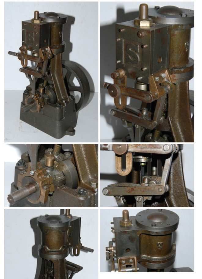

does anybody know of the avarage prices a stuart 5A would go for (machined and ready, or almost ready to run), since I neither have a milling machine nor the time to built one from castings. besides that, I have read somewhere that the modern stuart casting quality has decreased dramatically.
Quite frankly I do not want to risk buying castings and trying my own luck at making the engine myself at the moment, since I dont wan to waste money on ruining a set of casting, plus I will be more than occupied making a boiler and restoring the boat hull, along with saving enough money along the way.the engine building will come in the future when I change to a larger hull and (8-10 hp) engine.
Mike: do you know a adress where they could have such a crankshaft, and pin. Or maybe even a suitable engine.
regards Quinten

however I was able to find one, the engine costs 1200 euro. it is a fully built 5a with reverse linkage, apperently the bore is well made, but according to the owner the link to the valve chest needs work (It appears to be missing, at least I believe something is missing), and threading of the steam inlet and exhaust ports needs to be done, seems on the picture that it hasnt been threaded yet, and therefore never run (i think). it is not painted, and looks as if it is rather old but pretty well in shape.
it sounds like a good deal to me, however I am an amateur and never had a steam engine before. so yeah I basically have noooo idea.
i am quite close to buying it, but the owner is not a steamboater and does not guarantee the workings of the engine as he has just taken them over and never used them. based on that I am a little skeptical, and would only buy it at a lower price.
would love to hear your opinion
regards Quinten
