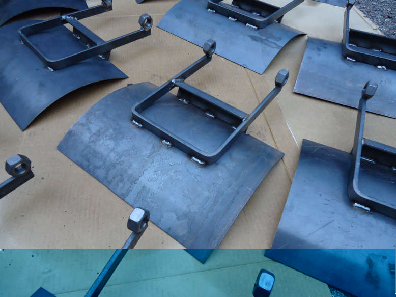

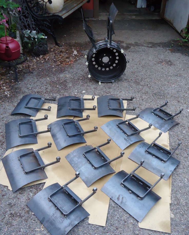

Working on the articulated wheels, have made 16 floats so far. Most of the work is putting together a jig to hold the parts together for welding. After the jig is made, the parts cut and formed, then welding one together takes only about 15-20 minutes. Still plenty of work, spent Friday Saturday and Sunday on the floats alone. Still have to make 18 spider links, plus the outer strake on the paddleboxes (probably 2 x 4 red oak), plus the spider bearings plus.... plus... Hope It is all together for the first steamboat meet in June.
Welded Float Close-Up
Welded floatscloseS.jpg (49.79 KiB) Viewed 11414 times
Welded Floats and their Swing Arms
Welded floatsS.jpg (107.27 KiB) Viewed 11414 times
