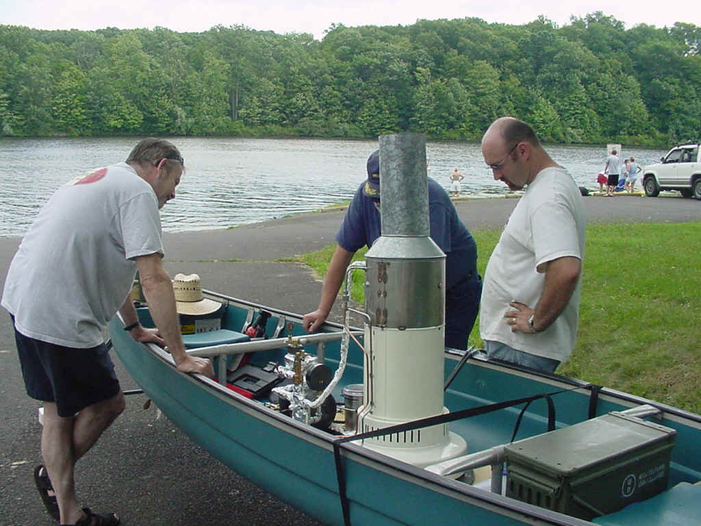

My first steamboat, a 15 ft Coleman Scanoe, car top mounted, with the "drop in" power unit mounted on a 2ft x 4 ft plywood board, carried in the back of the SUV. Stability was OK, and used an outboard lower unit to creat an I-O drive. See "Steam Scanoe" on Radow's website.
I have seen similar setups where the steam power unit, including sidewheels, drops into the canoe type hull before launching. Somewhat easier because drive shafts and the Inboard-Outboard setup does not need to be made. Space is at a premium, one, at most two persons, and difficult for the Fitch indian paddle configuration.
