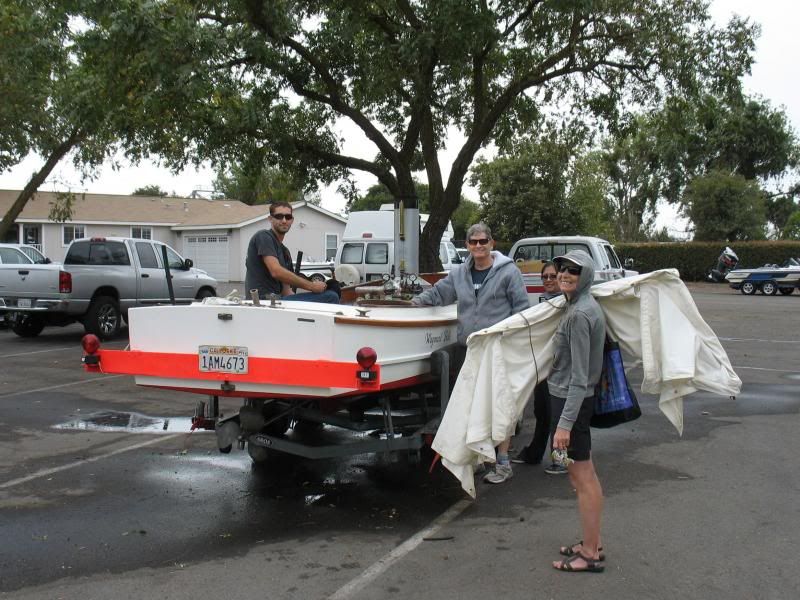

I've stripped all of the lights off of my trailer (which, incidentally is three feet shorter than my boat). Lights submersed in water, especially salt water, die rapidly. Even supposedly water proof ones!
I have a removable light bar, also with LED lights, that is either on the boat when towing or on the trailer when moving it empty. Just like removable towing lights. The light bar even holds the license plate.

I've done exactly the same thing. Keeps everything working.Lopez Mike wrote:I've stripped all of the lights off of my trailer (which, incidentally is three feet shorter than my boat). Lights submersed in water, especially salt water, die rapidly. Even supposedly water proof ones!

Same here... I seem to recall John Noble being one of the early champions of that method, mounting lights on the transom of his "Ranel II"
In fact I think this is a picture one of you two (or your wives) took:
The cheap magnetic lights have since been replaced with nicer LED trailer lights.
