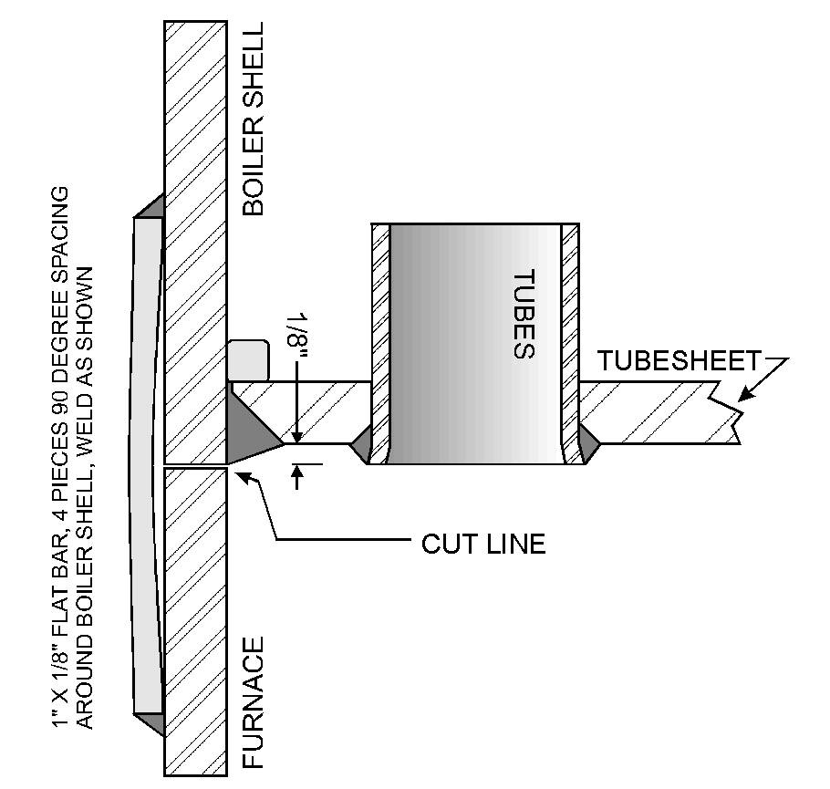

cyberbadger, great photos, and revealing. Certianly worth many words. I wrote a note to a person selling boilers on e-bay, I was interested in buying his boiler, until I found out it had a serious violation of boiler construction rules. The note is repeated below:
"I know free advice often is ignored, but I offer it anyway. I am a professional engineer, working in the steam power industry for several decades, and often use the ASME Boiler and Pressure Vessel Code. The boiler rules require that the shell extension beyond the tubesheet should not exceed 1/8 inch if exposed to furnace gasses above 850F, and not otherwise water cooled.
It appears to me that your design has the shell extending well into the furnace space where it can be overheated by the fire. One simple remedy is to have the boiler shell length the same as the firetube lengths, and attach a separate furnace tube, butted up against the boiler shell tube, but not directly welded to it. The attachment of these two parts can be made with tabs on the outside diameter of the shell & furnace, perhaps four flat bars, 1/8 x 1 inch, about 4 inches long, spaced at 90 degree intervals, with a weld at each end of the flat bar (one inch long weld beads). One weld on the boiler shell, one weld on the furnace tube, each weld about 2 inches from the furnace/shell butt joint. That would allow the furnace tube to go to higher temperature, and freely expand without adding stress to the boiler pressure vessel. A similar bolted arrangement could also be easily made."
The reason for this ASME rule is because the high temperature furnace section runs much hotter than the tubesheet (as clearly illustrated in the photos), and hence forces powerful thermal expansion on the tubesheet weld. Every time the fire is running, a much higher stress is imposed on this critical weld, tyring to tear the boiler shell away from the tubesheet. This stress condition also has complete reversals when the boiler is shutdown, another serious issue can result here, fatugue stress, which may result in failure after a certian number of repeating cycles, depending on the properties of the metal.
If this is the case with the illustrated boiler, or any similar ones, then the modification suggested above should be implemented. The suggested modification (cutting the shell to separate the furnace section from the boiler section) would take about an hour with a common 4-1/2 inch cutoff tool, after proper measurements and work setup had been completed. One other method would be to insulate the lower furnace tube section from the fire, and thus preventing this tube section from getting significantly hotter than the boiler steam/water section. This fix however is far less reliable, and reduces furnace usable volume significantly.

- S-F-ASME.jpg (73.93 KiB) Viewed 15086 times
