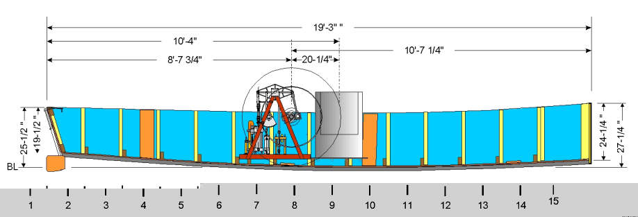

Allternately: I built my 20 foot sharpie boat in just 12 weeks, while holding down a full time day job. It is made very heavy duty with 5/8 and 1/2 BS1088 marine plywood, 1-1/2 x 3 Douglas Fir frames, 16 inches on centers. It is epoxied inside and out with 10 oz cloth, with double the cloth on the chines. The bare hull was completed just 5 days before the last steamboat meet of the year, but I managed to install the engine, boiler, feed tanks, pumps, paddle shafts and paddlewheels, along with all of the connecting piping, in time for the steamboat meet. While not a traditional fantail, the boat has performed well these last 5 years, and now I usually choose steaming to woodworking, although it is a never ending process in perfecting the hull/decks/seats, etc . Cost of just building the hull is about $2,000 US it weighs around 1,050 pounds. I bought a used boat trailer from the local boat supply house for $650, and modified it, needed bunks and a new heavy duty axle/wheels.
- 193inboardprofilemid.jpg (37.45 KiB) Viewed 15257 times

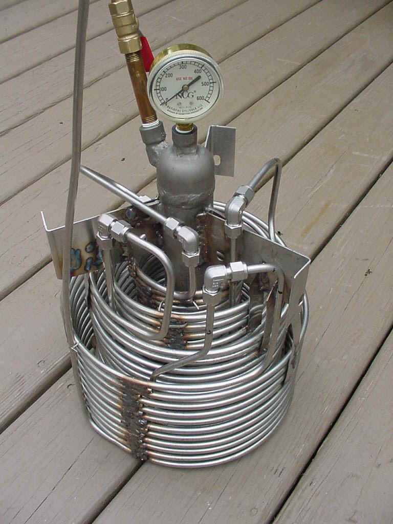

As to operating pressures for a steam launch, any pressure from 15 PSIG to 4500 PSIG could be used, with safety. As Ron states, proper design and proper operation determines safety, it is not a function of operating pressure. However to move very far from the norms of our hobby, typically 100 to 150 PSIG, is to invite complications which will probably interfere with happy steamboating. For example, Steam rated valves (marked SWP) are common for 125 or 150 PSIG service, finding valves for higher pressures is 20x more difficult.
According to the ASME Boiler & Pressure Vessel Code, Copper alloys for any part of a boiler are prohibited beyond 406F, corresponding to 250 PSIG saturated steam pressure. You are not allowed to use copper alloy (Brass or Bronze or Copper) for valves, for sight glass, for try cocks, etc. I know Stanley Steam boilers, using copper firetubes, were run well above this current limit, but that violates the current boiler codes, and cannot be recommended here.
So if you want to build a 600 PSIG steam plant, you will probably spend far more on design and materials procurement than would be considered prudent. Having said that, the Whitecliffs project used 600 PSIG steam, and achieved probably the best efficiency for small reciprocating plant service that I have ever found in the last several decades.
As to welding, " other words, consult with the welder before you do more than doodle on paper" .... I would recommend weld designs be developed by weld designers, not necessarily a welder. An experienced welder gets his experience from performing welds that have been detailed on the plans he is following, but that is not to say that the welder knows anything of weld stress considerations, etc. You need a good, qualified welder to make good welds, but that valuable skill says nothing of the welder's capability to design and size welds according to stress criteria.
- 5000 PSI Design Pressure Steam Launch Boiler - 2004
- T47BoilCoil.jpg (76.02 KiB) Viewed 15155 times
