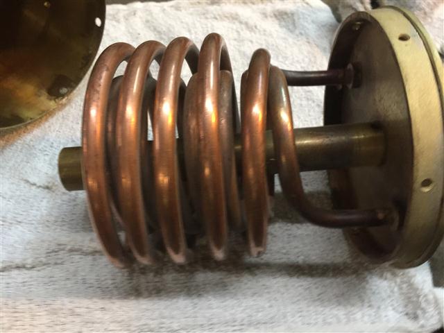

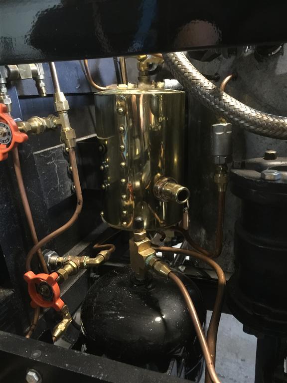

I added the muffler to the Loco which has another feedwater heater in it, with the economizer results in two separate feedwater heaters (Navy ships had five preheaters). It will now take on feedwater under demand and actually gain boiler pressure.
Some pics of the muffler:
Hi Fred, My friend made one of those and it would close at temperature and then he could never get it to reopen until the system shut down. It appears that the way it is piped per the Ofeldt drawings showing their piping configuration it somehow relied on cold feedwater to cool the tube and retract, which in turn pushed cold water to the boiler (a no-no). There are a few different drawings floating around showing a design evolution possibly. The problem is or as we understand it: The tube is very short, The difference between boiler water temperature and steam temperature which is not great, results in an expansion/lengthening of the brass tube somewhere in the range of .020". So, not a lot of motion to play with. I have no doubt that it worked, no one I know has been successful in trying.
The long tube Stanley type is known to work very well with the boiler water/steam temperature differential. Easy to make too.
