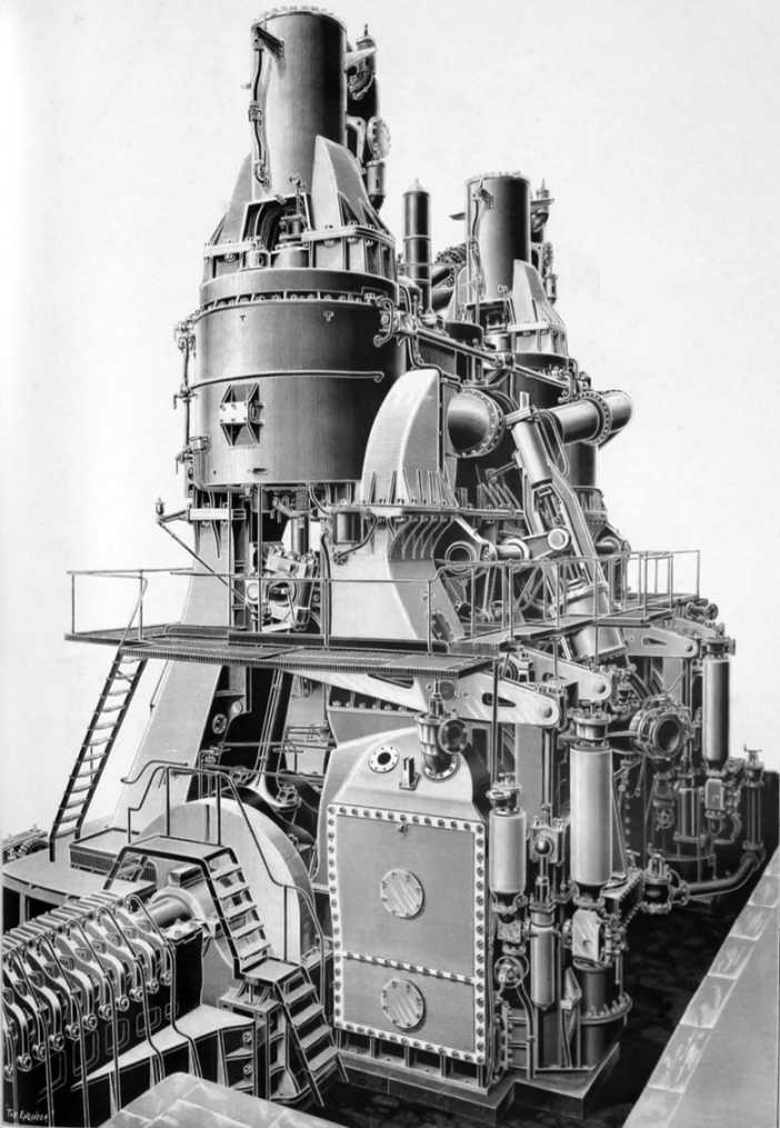

And a very much larger marine engine, the triple expansion 5 cylinder recips of the Campania, 47 feet high, 165 PSIG
37 inch HP Bore x two cylinder, 79 inch IP bore, 98 inch x two cylinder LP bore, with 69 inch stroke. (940mm HP Bore, 2007 mm IP bore, 2489 mm LP bore, inch x 1753 mm common stroke). These engines were 15,500 IHP each @ 79 RPM, twin engine installation on an 1893 liner.
The most powerful marine reciprocating engines in steam I have found. Notice the size of the "power reverse" cylinders, needed to throw over the Stephenson Links for cutoff and forward/reverse control.
Re: digital steam engine indicator
Looking at that got me thinking. Did anyone produce a compound engine with two highs feeding a large low?
Mike Rometer wrote:Looking at that got me thinking. Did anyone produce a compound engine with two highs feeding a large low?
I think they went the other way - one high, one intermediate, and two low pressure cylinders, since otherwise the pistons got too heavy and the castings were really awkward. The Titanic has such engines:

Eer, the HMS Campania engines pictured above DOES have 2 high pressure cylinders feeding an intermediate pressure cylinder. rp
