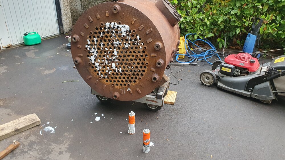

Well, in for a penny in for a pound!Dhutch wrote: Tue May 27, 2025 10:17 amAt which point, various advice including my gut feeling and a chat with the lead chemist at work, has lead me to the suggestion of using domestic oven cleaner, while wearing eye protection. After all it is formulated for removing baked-on grease from steel, it is very alkaline which is basically all you are after, and has suitable thickening agents for spraying/soaking/rinsing surfaces you can't soak. Plus it's easy to get hold of at the supermarket!
I have also procured an extra long thin lance for my pressure washer (a 1.5m 1/4" BSP stainless steel tube basically) so once it has soaked in the oven cleaner spray I can then jet wash it to mechanically remove the loosened material, and try and wash it all out of the wash out plugs. Might hook the hose up to the hot tap too and feed it warm water for good measure.
This is all theory to date, but I shall post back in a few weeks!

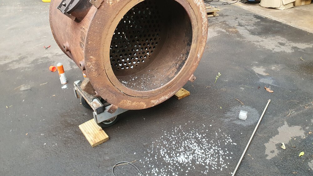

The overall outcome wasnt great to be honest.
Firstly its unsurprisingly hard to get the stuff where you want it. The fitting on the aerosol nozzle wasn't the common type, which ruled out swapping it for one a straw to get a jet rather than a mist, so I ended up just opening it out with a small (1mm I think) drill bit and doing what I could to get it on the tubes, which involved looking through one hole, spraying through another, and regularly clearing foam from the nozzle area and swapping to another hole in the tube plate having filled that one with foam. All while in disposable nitrile gloves and workshop goggles, trying really had to not get it on my skin on on my eyes. I also had a bottle of the 'tip into a bag and soak the trays' gel which I mixed with 50% water, stuck in a pump up hand sprayer, and again sprayed half blindly into the drum at the tubes, this time mainly aiming for the undersides of the tubes which I couldnt get at all with the aerosol. Photos below of the coverage.....
....left all of that for half an hour and hour, and jet washed it all off with my 1500mm extra long pressure washer lance, For about an hour, doing my very best to clean all the surfaces of the 19 stay tubes, as well as the foundation ring, and washing out all the lumps. Having hoovered out 90% of the loose stuff when it was dry.
Then I left it all to dry, and reviewed what I was left it. Well it was a bit better... ...but a long way from clean tidy nice to inspect metal.
So I then made a scraper I could get through a tube hole and run along a tube, and with that, and a good torch, almost as much by feel as visual, myself and the boiler inspector were able to gain enough confidence that the wastage after 30 years service was not significant and we could continue with the retubing.
