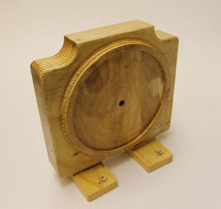

My dad built a Dake model, and I made a set of model Dake plans that are pretty accurate.

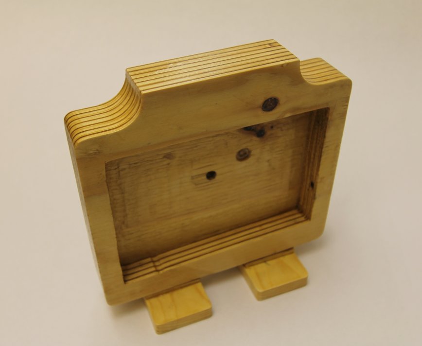

The clearance between the pistons (2) and the crankcase can be adjusted by removing shims from the crankcase cover.
The engine really has very few parts, and is much easier to make (assuming you can cut and lap a flat surface) than a traditional steam engine with crosshead guide, eccentrics, and all sorts of other parts.
I have started the patterns for a model of this engine, and the crankcase measures 5" across.
I will be cast the engine in either aluminum or perhaps gray cast iron if I get lucky.
The drawings for the model are located here:
http://www.classicsteamengineering.com/ ... opic=946.0

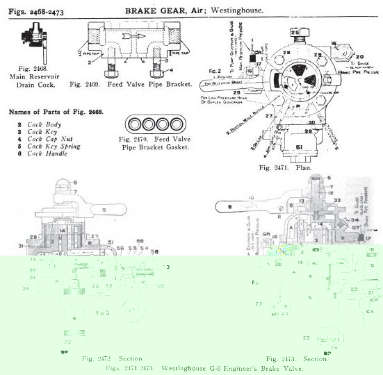

The Dake reversing valve looks exactly like a Westinghouse locomotive air brake valve; engraving attached.
- Westinghouse-Air-Brake-Valve.jpg (65.84 KiB) Viewed 10666 times
