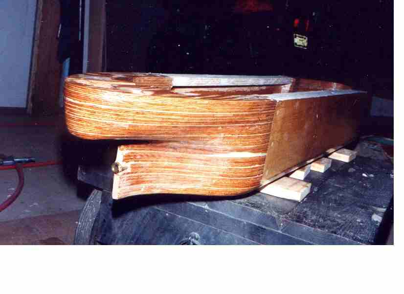

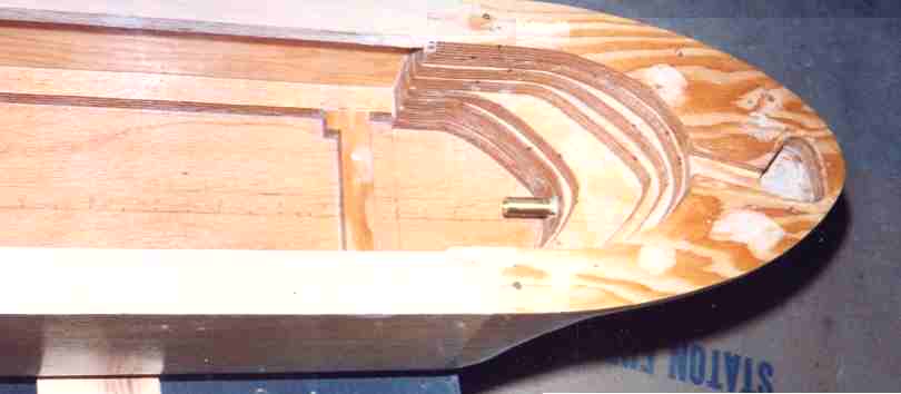

- Posts: 1926
Re: Hello from Minnesota
Built a model steamer with the "Bread and Butter" method, several layers of 3/4 inch thick plywood, cut to the hull form in horizontal sections, screwed together with automotive body putty (Bondo) between each layer. Some rasp work, filling as required with more Bondo, and a good hull resulted. Epoxy would be better than the Bondo, but the hull was made more than 25 years ago, and has no problems.
56 inches long, loaded weight of the small ship is 66 pounds, with the big Saito twin steam engine driving a 4 inch diameter propeller. Four channel RC, Rudder, whistle valve, Forward/Reverse, and Main Steam Valve.
- UE-Muskrat.jpg (35.41 KiB) Viewed 11906 times
- UE B-B SternS.jpg (15.67 KiB) Viewed 11906 times
- UE Hull 1S.jpg (27.4 KiB) Viewed 11906 times

Thanks for the info and pictures, Fred!
If I don't purchase a hull I will most likely try to construct a frame and sheet it with wood. What materials are recommended to build the frame and sheeting?
