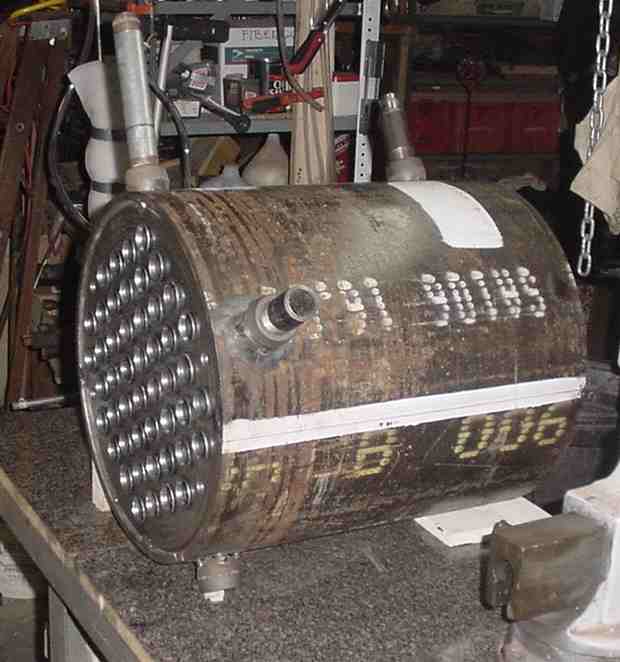

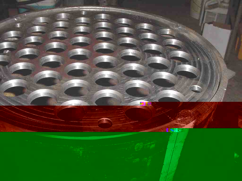

Just for consideration, I did most of the design & manual labor to get my ASME stamped boiler, and paid as follows:
Purchasing Materials for a simple VFT - about $600 in 2010, with all material certifications:
Shell, 16 inch OD 3/8 wall x 18 inches long, ASTM A106 B cost $278
Tubesheets, 15 inch diameter x 3/8 thick, Material Purchase ASTM SA 516-70 Gr B cost $99
Boiler Tubes 1.25 OD x 0.095 wall x 18 inches long, ASTM A178 cost $169
Welded/Screwed Fittings, ASTM SA/A 105 3000 LB cost about $50
Tubesheets, Machining, E-Machine Shop, 48 reamed holes, Perfect Job, cost $485
Boiler Fabrication & all Welding, Design Review, ASME and National Board Stamping,
Columbia Boiler, Pottstown PA cost $890
So for the basic boiler pressure vessel, about $2000 with a code stamping. Of course, SRV, sight glass, valves, etc., burner, firebrick setting, lagging, smoke hood and stack are homemade, and not boiler safety issues.

- Tubesheet Tacked into Shell
- TackedTubesheetClose.JPG (50.55 KiB) Viewed 11039 times
- Boiler ready to go to the ASME Shop for Fabrication
- Boiler-Tubes Rolled.jpg (33.67 KiB) Viewed 11039 times
