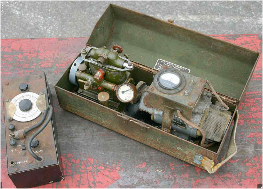

As far as small steam-electric plants go, there were two (that I know of) provided to charge batteries during WWII. The British model used the Stuart Sirius engine, and would burn anything that could be found. The USA version was similar, but certainly more robust (and more weight, and more expensive) and would burn anything that could be found. Around 1900 Westinghouse made many enclosed crankcase engines, always two cylinder trunk type engines, simple or compound, with a very good service record.
Plenty of power can be made with compact steam plants, the most extreme examples are the British steam hydroplane plants, packing several horsepower into a plant similar in size to a shoe box. But these plants all burn liquid fuel, run at several thousand RPM, and need all kinds of maintenance. They are also very loud, rivaling the noise of racing IC engines.
