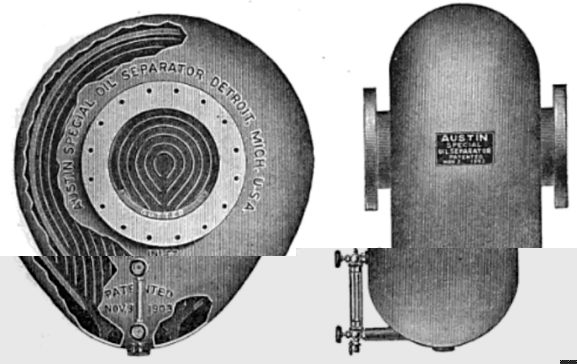

From Lionel: "Is there any (reasonable) means of catching any of the oil between the engine and the condenser? i.e. reducing the amount of oil that goes through the condenser?"
Steam exhaust oil separators were very common 100 years ago, generally a device to provide centrifugal spin action, throwing oil (and water droplets if the steam is wet) against the outer walls of the vessel, with exhaust steam exiting from the center. Other types used extended surface impingement baffles, usually with healthy serrations on the surfaces to catch and drain the liquids.

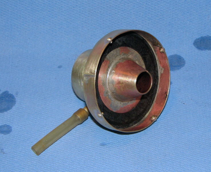

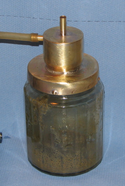

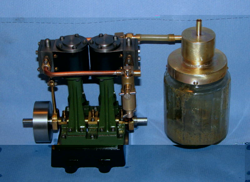

Hi Lionel,
Best Dietrich
i have built for my engine test stand a cyclone oil separator shown below from a jam jar. The principle is very simple and effectively. There is no oil in exhaust steam. It could be built also in other dimensions and a sight glass is recommended. The collecting vessel should have a good insulation for a low condensing rate.Lionel Connell wrote:Is there any (reasonable) means of catching any of the oil between the engine and the condenser? i.e. reducing the amount of oil that goes through the condenser?
Best Dietrich
