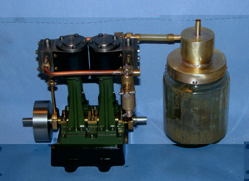

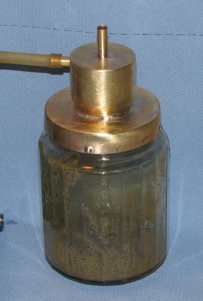

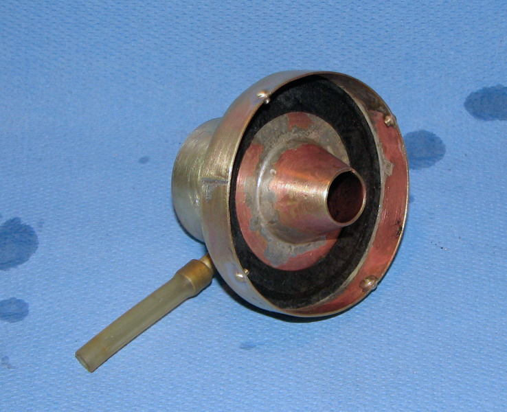

by dampfspieler
Hi Lionel,
Lionel Connell wrote:Is there any (reasonable) means of catching any of the oil between the engine and the condenser? i.e. reducing the amount of oil that goes through the condenser?
i have built for my engine test stand a cyclone oil separator shown below from a jam jar. The principle is very simple and effectively. There is no oil in exhaust steam. It could be built also in other dimensions and a sight glass is recommended. The collecting vessel should have a good insulation for a low condensing rate.
Best Dietrich

Many thanks, Dietrich, Wesley and Fred, just what I was looking for. One more thing added to my "to do" list. Maybe I can incorporate this into my exhaust feed water heater, which is also sitting on my "to do" list.
