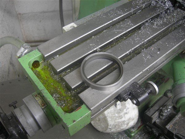

I took a suitable disc and carved a hole in it, bore size plus 0.010" i.e. 2.510", even at that there was some overlap so they could be +0.020" or even +0.030".

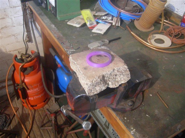

The ring stack was then placed on a fire-brick, and with the gas blow-lamp pointing straight down in the centre, heated as evenly as possible to a dull glow. Here I have to say that the camera seems to be lying, as it never looked that red to the naked eye.

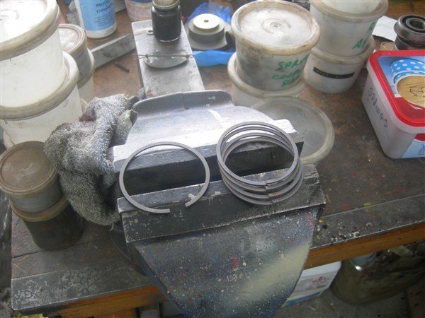

I allowed them to cool on the fire-brrick whilst I had a natter with a neighbour (15-20 mins?). On removal from the ring they opened very little, so I would suggest if doing this again, add at least another 0.010" to the bore as these are to my 'feel', just a touch on the slack side, though that may be Ok with steam. No matter because I can always set the gap and then treat them as new home made rings with a re-heat.

This last pic shows them with a new one alongside.
The rings seem to still be perfectly circular as I can see no light round them in the final bore. I do still have a few more so I could go round again with the bigger size dummy, if I feel inclined.
