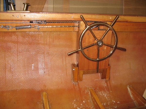

I am rather thinking of something along this arrangement.
Thanks
Ian
Will look into it.
Thanks
Ian

I like it! I like that wheel also!

Just spotted that photo again. For any of our colleagues who may be new to the hobby, could I explain that the two cables on the far left go to the quadrant mounted on the top of the rudder shaft. A quadrant is best because it keeps the lengths of the cables constant throughout the range of rudder movement. The spring is to keep the cables slightly tight and discourage the chain from jumping off the sprocket. The chain is standard bicycle chain and goes over an 'off the shelf' cast iron sprocket that has been slimmed down to accept the bike chain. The chain goes over two bike derailleur chain tensioner sprockets then down to the steering sprocket that is on the same shaft as the wheel. Between them on the shaft is a bulkhead bearing bolted onto a wooden frame which is hidden by the plywood 'modesty panel'. The frame is arranged to be free moving in a vertical direction also ensuring that the steering cables remain sufficiently tensioned. In the final implementation the shackles, spring, etc were put through two pieces of old bicycle inner tube rubber with the end crimped by small cable ties. Like condoms they avoid one being caught out by unexpected problems (like the shackles locking together or getting caught in the spring.) It is nice and simple and works well.
That must be the one bit of technology I have not changed in Frances Ann'e re-fit.

Brilliant, thanks Pete.
Now I can get my head around it too.

Now that you have used it for a while, do you think the tensioning spring is necessary?
I've seen it used and needed with systems using a tiller arm instead of a quadrant. I suppose that if the hull flexed it would be needed even with a quadrant.

Actually the spring is unnecessary as the wheel/sprocket assembly uses gravity to keep things tensioned. I suspect that I got the spring as a result of a telephone order to some supplier who probably insisted that it would be necessary. As it is all hidden away under the coaming I don't know if the spring flexes at all in use.
Re: Wheel sizes ?
My thoughts are, that whilst the spring may not be truly necessary for tension it will provide some protection, both to hand and steering gear, in the event of rudder collision with some unseen underwater obstruction.

Backlash in steering gear is far from the end of the world, but it IS irritating, and a spring tensioner is very simple and largely removes it.

I would think the spring would help dampen the "beat" of the propeller wash also.
