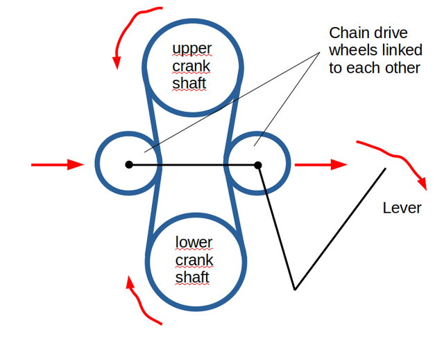

The only valve-less way to steer the engine would be to change the offset angle between the crankshafts. :idea: I found 2 ways (either by an adjustable chain gear or a gearwheel mechanism) to do so, though with a big disadvantage. The mechanism would work against all the engine power, unlike a separate valve train. So, a governor would have to be very strong/hydraulic to overcome this (And the problem with the small effective displacement space described above would still be there.).
This would have been one of my proposals for a solution (excuse my sloppy drawing skills):
The lever at the side pulls the small sprocket wheel on the left into the chain. This neccessitates a bigger lenght of the chain to be on the left side between the crankshafts, causing the crankshafts to alter their angular alignment to each other. All the while on the right side, the chain would become stiffer, straighter, "shorter" and the small sprocket wheel needs to travel outwards to give some space.
But the issues remain: The full load has to be overcome to alter the power output and the small displacement space remains.
That is why I chose to include inlet valves, rendering crankshaft offsets obsolete. Now, the pistons move away and to each other perfectly synchronous, using the TDC of each piston as the intake side, plus giving each piston a separate exhaust port. Like 2 single-acting uniflow steam engines sharing one cylinder head side.
To realize an opposed-piston steam engine, that can have the same efficiency as a normal uniflow engine and is still steerable, the easiest way would be to have inlet valves.
