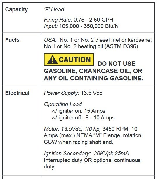

The Beckett style burner for a house furnace which is similar in duty will draw close to 1500 watts with igniter on at start and then drop back to about 300 watts once ignited.Lopez Mike wrote: Wed Aug 21, 2019 1:28 am I just sent Beckman an email asking how many amps it draws. Somewhere I got the impression that it was around five amps.
The math on that (volts X amps = Watts or Watts / Volts = Amps) at 12 volts works out to about 125 amps to start and 25 amps to run. A good comparison is a heater blower motor in a car, they are typically fused at 30 amps. I recall one forthright steamcar guy that had a converted house burner from 120 Volts to 12 volts and he said he could get about three hours continual operation off of a fully charged battery.
I started to put one on the Tug as a secondary backup in case I ran out of wood - Just another firebox door with a beckett burner mounted that could be quickly swapped out, the power consumption nixed that idea.
It's possible there are smaller more efficient 12 volt burners, I'm curious to know what Beckmann has to say.
Edited: I looked around after this and found a PDF on the Beckett factory 12vdc burner. Looks like the factory model doesn't draw as much as the converted units, or the math suggests. I may have to rethink using one for backup.
https://www.beckettcorp.com/wp-content/ ... Manual.pdf
- becket 12 v burnerspec.jpg (72.48 KiB) Viewed 30674 times

From that spec sheet it seems that the firing rate is variable. I hadn't thought of that.
