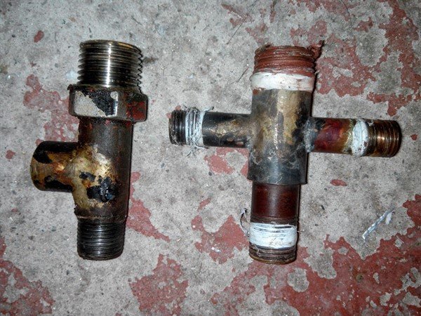

Sod's Law is still alive and well here as I recently discovered. I needed to connect a new pipe to the gauge that will show the pressure of the steam at the manifold, i.e. after the regulator. The engine came with a suitably placed tee on the main steam line into which was screwed a bolt. Having unscrewed it and measured it I discovered that it was M8 which is not really suitable for any fitting that I have. I considered counter boring the tee to 1/4 BSP, but decided that would leave rather thin walls. So Plan B was to counter bore the hole to M10 and make up a nipple with M10 at one end and 1/4 BSP the other.
Having dismantled the steam line as access in the boat was zero, I found that the tee piece was a made up item with a very thin main line walls and a soldered on solid chunk of round brass bar (drilled M8) for the tee. I was also surprised that one end of the main line was threaded 1/2 BSP and the other looked like 5/8 BSP. Holding the tee in my hand I got this feeling that I had seen something of this size before, so went to rummage in the pipe bits box. My memory was correct in that I did have just the thing. A nice brass cross that Gregg had made for the auxiliaries feeds but now spare due to changed plumbing. Even better it was threaded 1/2 BSP one end and 5/8 BSP the other and was exactly the same length, not to mention the two 1/4 BSP outlets. Clearly my luck was in.
Two Tees (600 x 450).jpg (92.17 KiB) Viewed 11008 times
Since the through bore of the X piece was about 6mm, I had a quick check of the regulator valve and was surprised to find that it was 9mm diameter. The X piece was plenty strong enough to be re-bored to 9mm so that was done next. As a Happy Bunny I then set about re-assembling the main steam line with the X piece rather than the original tee. The 5/8 end screwed in so far and then stuck which seemed odd. I was sure that the threading was parallel not taper so undid it again.
At this point the new state of the X piece thread about half was down raised the spectre of a different thread standard in the subsequent piece of the steam line (another tee). Much dismayed I went off to search out what might be going on. The likely answer was soon available. It seems that 3/8 BSP is 19 TPI while 3/8 NPT is 18 TPI.
Why, I wonder did the engine builder use a pipe fitting with a non standard (in Britain) pipe thread? After all galvanised tees are not hugely expensive... Happily, plan B was still on the table so that is what I had to do next. Wouldn't it be nice if the UK were to adopt a nice simple and standardised set of pipe standards? In chasing 1/4" BSP fittings I have discovered that the model making fraternity don't use 1/4" pipe with 1/4" BSP fittings...
