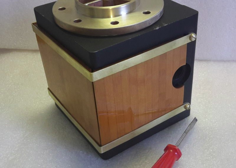

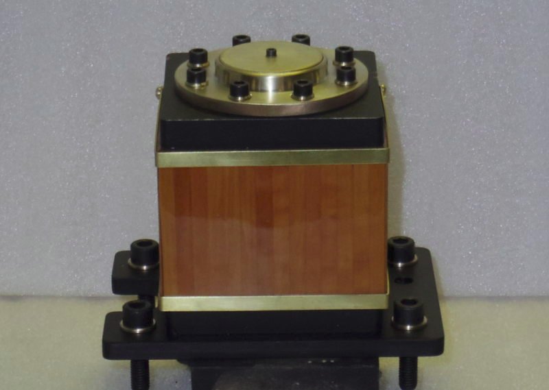

Hi,
the cover of the insulation is finished with EPIFANES and held in place with two bands of brass and screws.

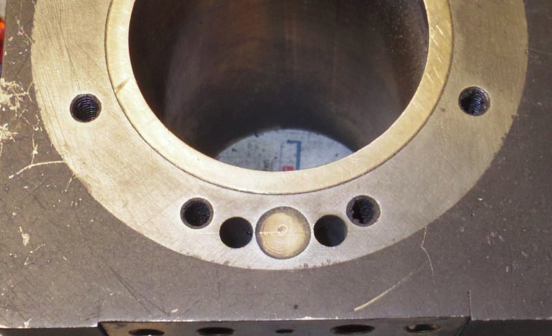

Hello,
i have calculated the ports and found them a bit small (154 mm²). So i have drilled two 8 mm-holes each side next to the ports (2 x 50,26 mm²). It is three times of the size of the drawings and enough. Optimal would be 260 mm² for 20 m/s steam speed at 750 rpm.

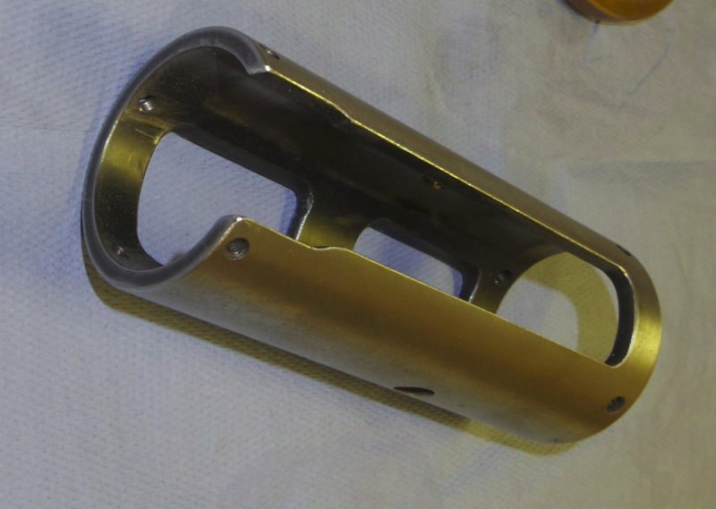

Posts: 289

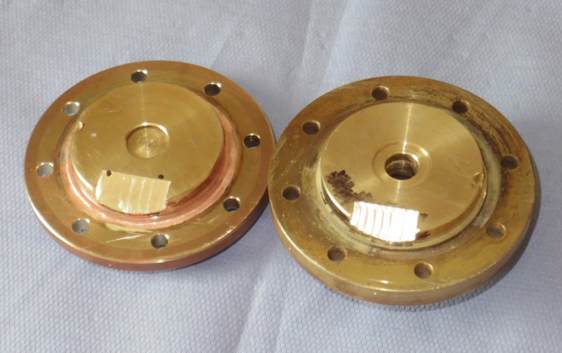

Re: My column-style steamengine - cylinder covers

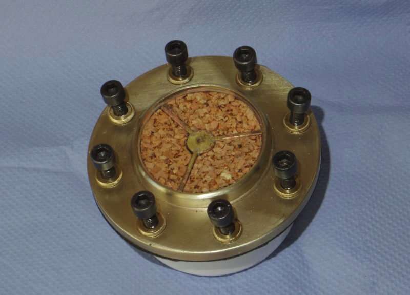

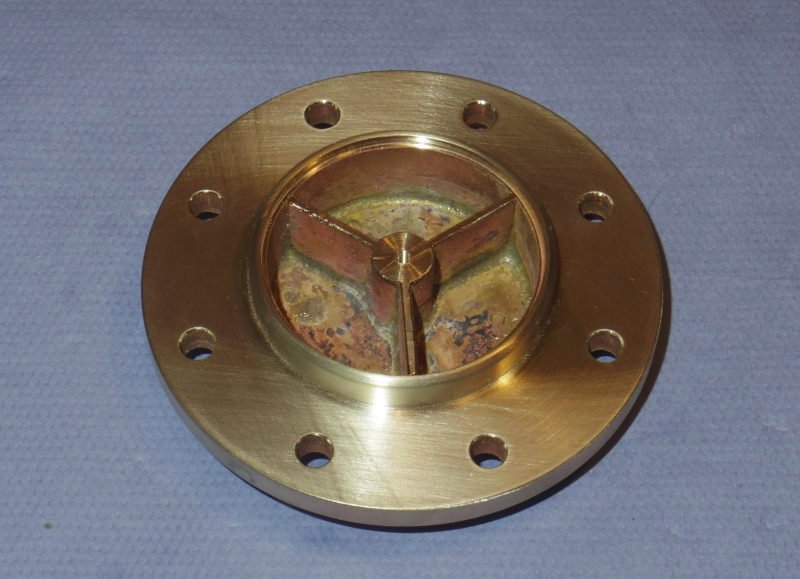

Hello,
because the cylinder covers were too shallow i have soldered two 8 mm discs of gun metal in place. That was a bit terrible but with a 75 kW-PROPANE-Burner the work was done successful.
Then i have it turned them to the right dimensions and milled the slots for steam and condensate.
Then was removed some material from the upper cover and soldered in some parts, so the gaps can filled with insulation and close it with a polished disc..
to be continued
-Dietrich
Posts: 289
Hello,
here some more pics. All bolts were replaced with black ones and turned brass washers to prevent the parts from grooves.
to be continued
-Dietrich

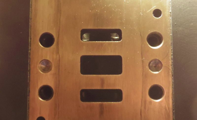

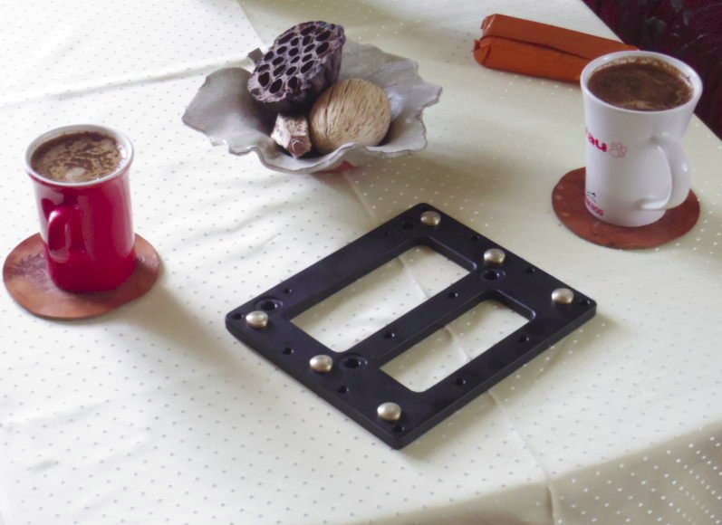

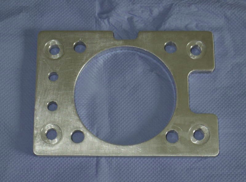

Posts: 289
Hello,
all aluminium parts were black anodized to prevent them from oxidation and also because it looks better - "Das Auge isst mit." ;) ;)
The base plate was revised and get some new attachment holes closer to the edge. The older ones were closed with brass parts. My wife thought it was very nice.
to be continued
-Dietrich

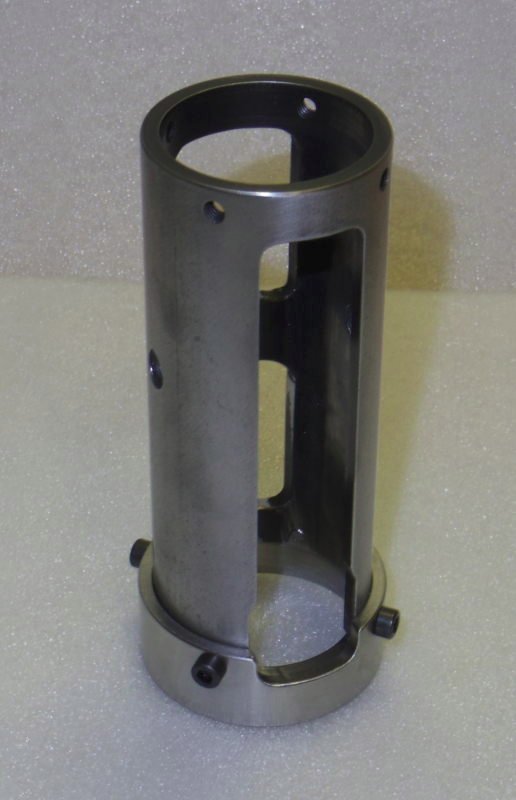

Posts: 289

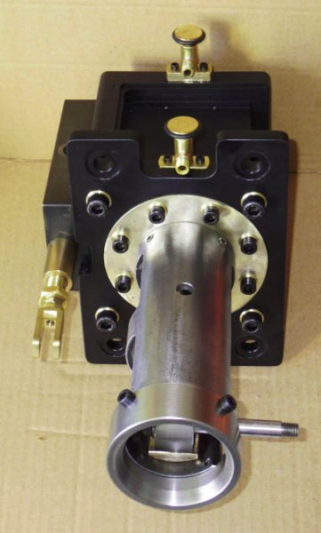

Hello,
the crosshead guide is a bit shorter than drawn - there was only a short pipe in the builders shop. So it was slotted completely at one side to allow the croshead bolt to move the stroke. So it was not round at its lower end and the crosshead could move in its lower dead center - there was a little knocking. I have turned a ring from stainless steel (1.4305). It is clamped to the guide and held in position with four screws.
to be continued
- Dietrich

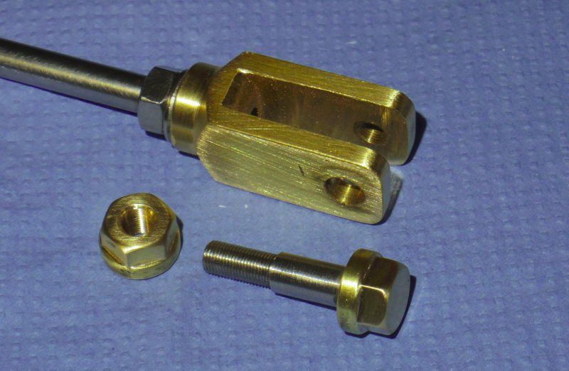

Posts: 289
Hi Mike,
:lol: :lol: don`t do so.
Hi Bart,
thank you, now i know a new idiom.
The valve rod was new built from stainless steel (1.4305) and also the valve nut and valve rod yoke.
The valve nut is drilled and slotted, so it is a clamp with two screws. The valve rod is shorter then drawn. There were no problems while the engine was steam tested because it is long guided. The yokes bolt is new built so it can screwed in and couldn't rotate while running.
to be continued
