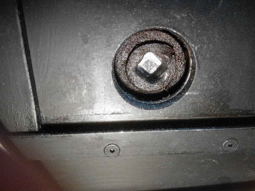

Well soaked with Kroil.jpg (131.28 KiB) Viewed 20678 times
Posts: 577
Re: Counter-clockwise Drill bits
Today Mike Rometer kindly came around to my house with his car boot loaded with equipment. We began by heating a large piece of steel round bar to red and then holding that against the plug. Two goes at that and it was felt that it was time to apply some turning force.
Setting a square tool with extension into the right hand plug and putting as much muscle power as was available into pushing was next. Result, much puffing but no movement. The same clouted with a hammer was equally ineffective. The manual hammer drive was then tried but again to no discernible effect.
It was at this point that the compressor was plugged in and set in motion. By the time the hose and the hammer drill had been sorted out the tank was up to pressure. The drill was fitted with a 1/2" square drive and applied to the task. There was plenty of noise but no movement from the plug nor from its mate which receives the same treatment.
Next the DeWalt 48v hand drills were deployed with some amusement that we both had bought the same cordless drill. A 13mm bit was used to create a centre dimple as this fitted the sockets rather better than the 1/2" bit. A pilot hole of about 6mm was made right through and then the 13mm was used to open it out. The astonishingly inexpensive, but guilt inducing, boxed set of Blacksmith drills with 1/2" shanks was then opened. Work began at 14mm and progressed slowly up to 22mm. At this point it was clear that the right hand plug was beginning to break up. The remaining bit of the plug that extended beyond the end of the mud drum was 'attacked' with a chisel and persuaded to start turning. It was then possible to knock out that half of the plug. At this point it became obvious that the Dremel work had probably moved the bottom of the socket off centre as the drilling had caused some damage to part of the threading in the drum.
As the fragments came out it was clear that there was no evidence of the presence of any of the penetrating treatments that had been tried.

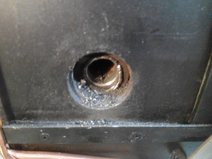

Not perfectly true.jpg (116.97 KiB) Viewed 20677 times
Next the 3/4" BSP tap was applied and the existing threading cleaned up. Fortunately, the new bronze plugs are quite long so that when test fitted it appeared to be very secure.
Posts: 577
The same drilling procedure was then applied to the left hand plug. However, in this case the centre drilling was pretty close to perfect and it was necessary to go up to 24mm to clear the old plug. After that drilling all that remained were the bits of plug thread sitting within the threads in the drum. Very difficult to remove, but they eventually came out as thin strands of metal.

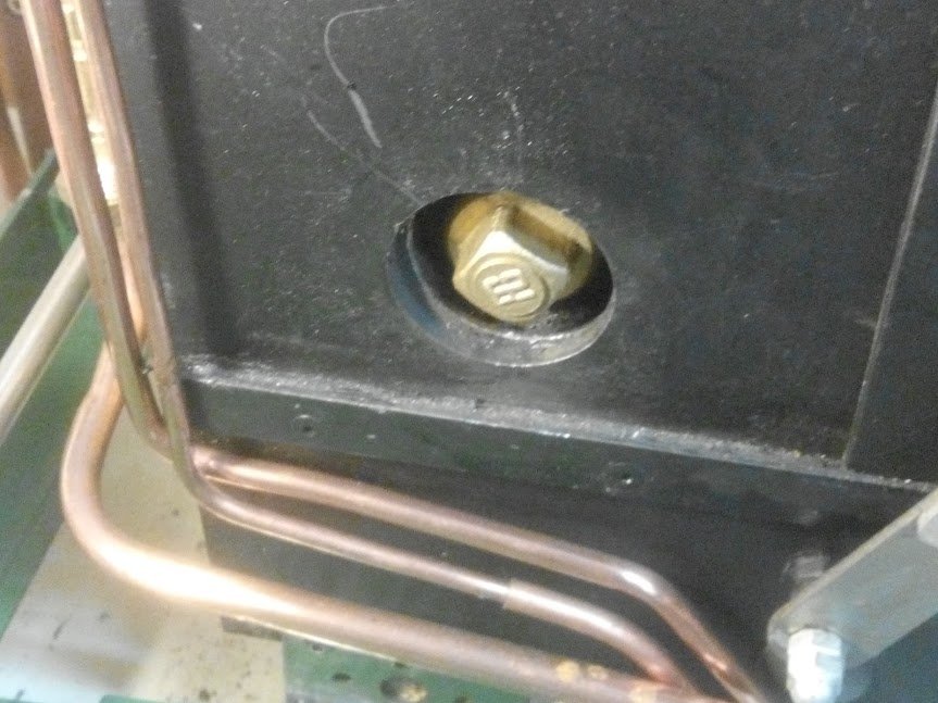

Nearly there.jpg (102.06 KiB) Viewed 20674 times
With them out, the 3/4" BSP tap was applied and the threads cleaned up. Finally the second plug was test fitted satisfactorily. The only thing that remained was to check that the locomotive style firebox doors would still open. Ooops! The trade name on the top of the plugs was just enough to snag. The plugs will now need that skimming off before the final fitting.
