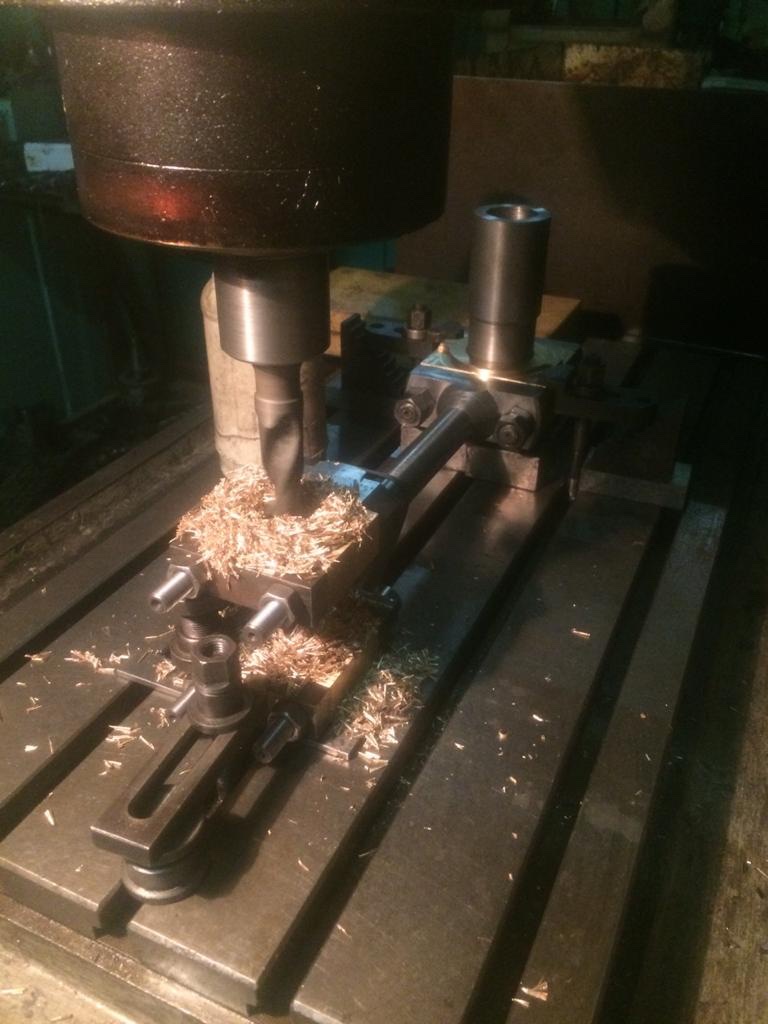

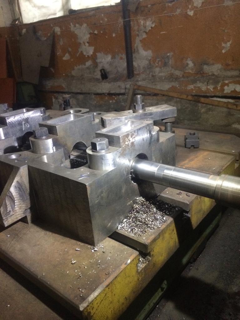

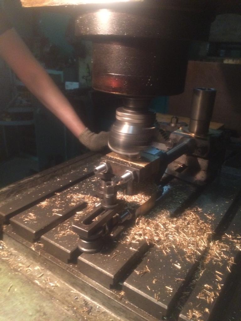

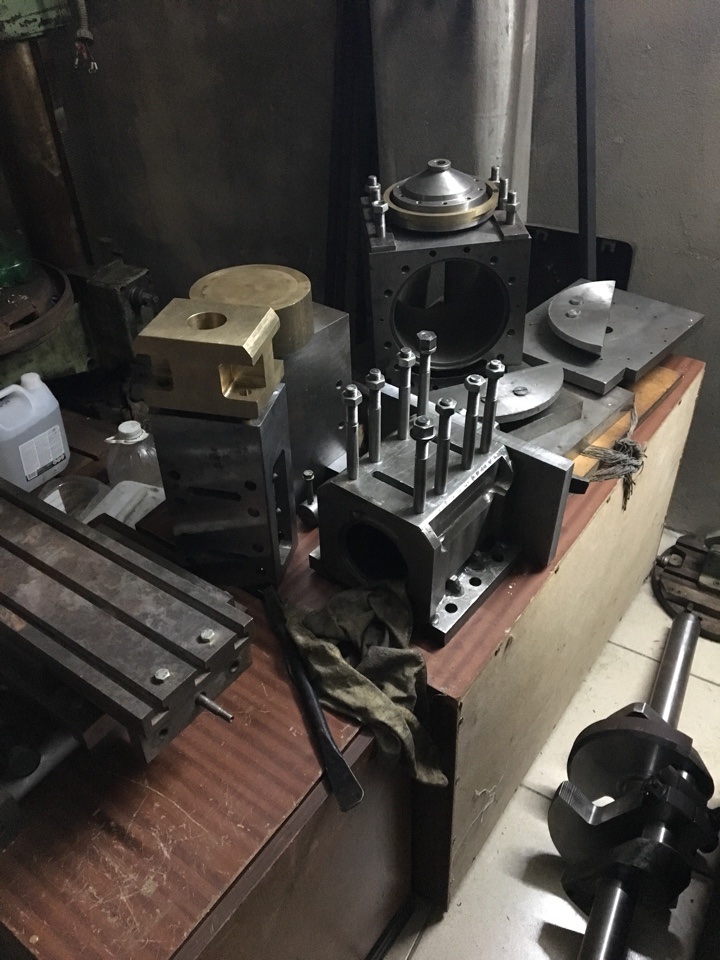

For me, pictures of my steam engine are better than pies. I am trying to attach pictures of my steam engine. Bed processing on a boring machine. Steam engine cylinders and spool box. I and my assistants made all the parts made of steel. Where I live, cast iron parts are not cast, it is easier to make steel. Machine machining is less expensive than making cast iron castings. Perhaps these photos will be interesting to someone.
