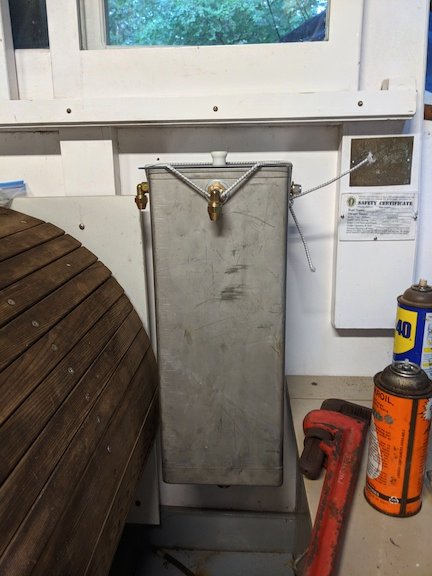

I made a new hot well a while back for Rainbow, but have had no chance to try it out as yet.... the float valve is actuated via a ball chain from the float to allow the use of a large float in a small space. The hot well is about 6"x7" inches or so, and about 20" tall iirc.
