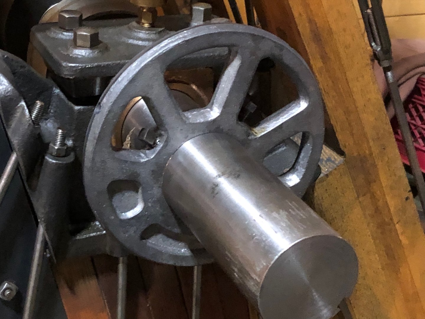

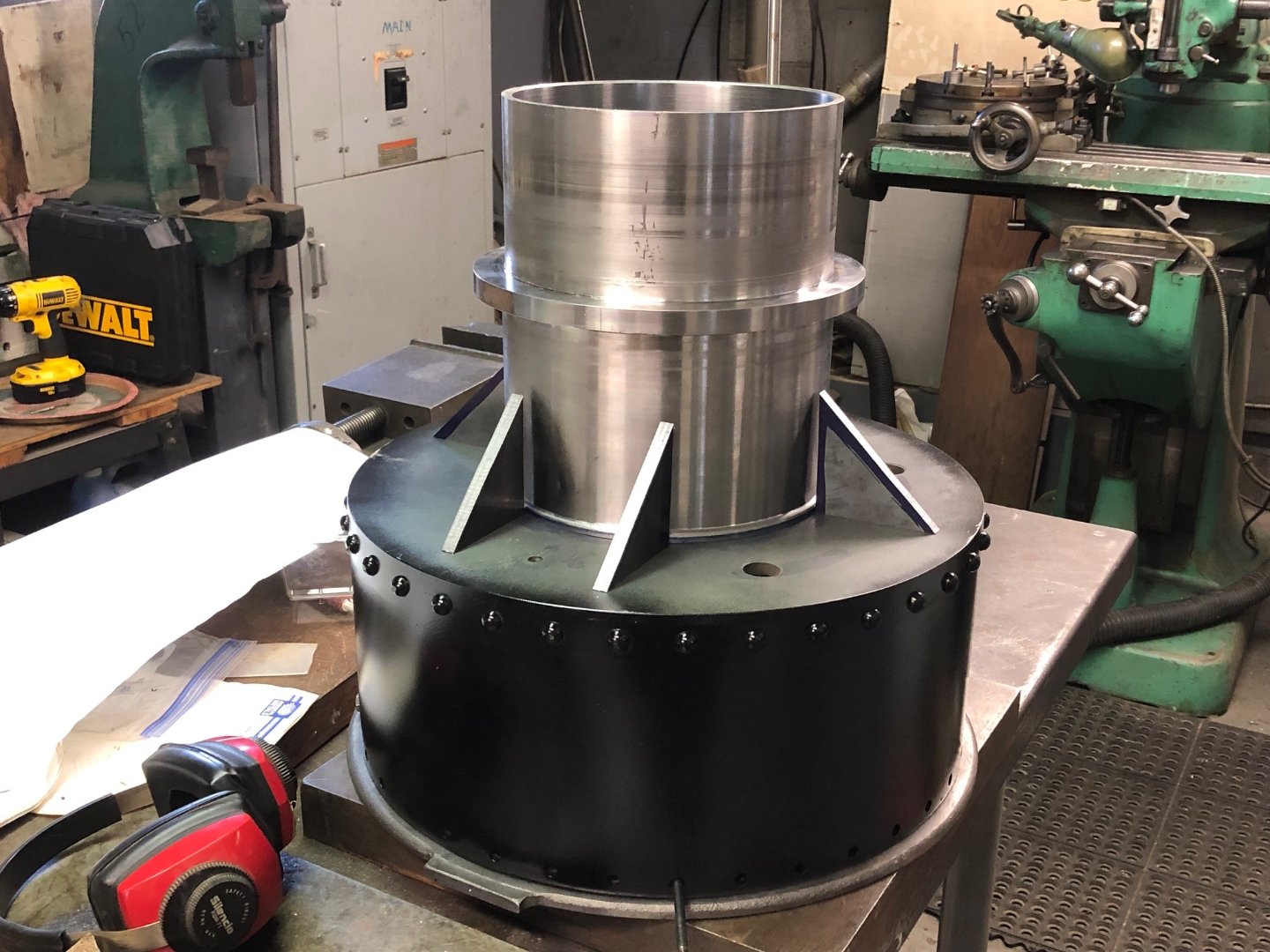

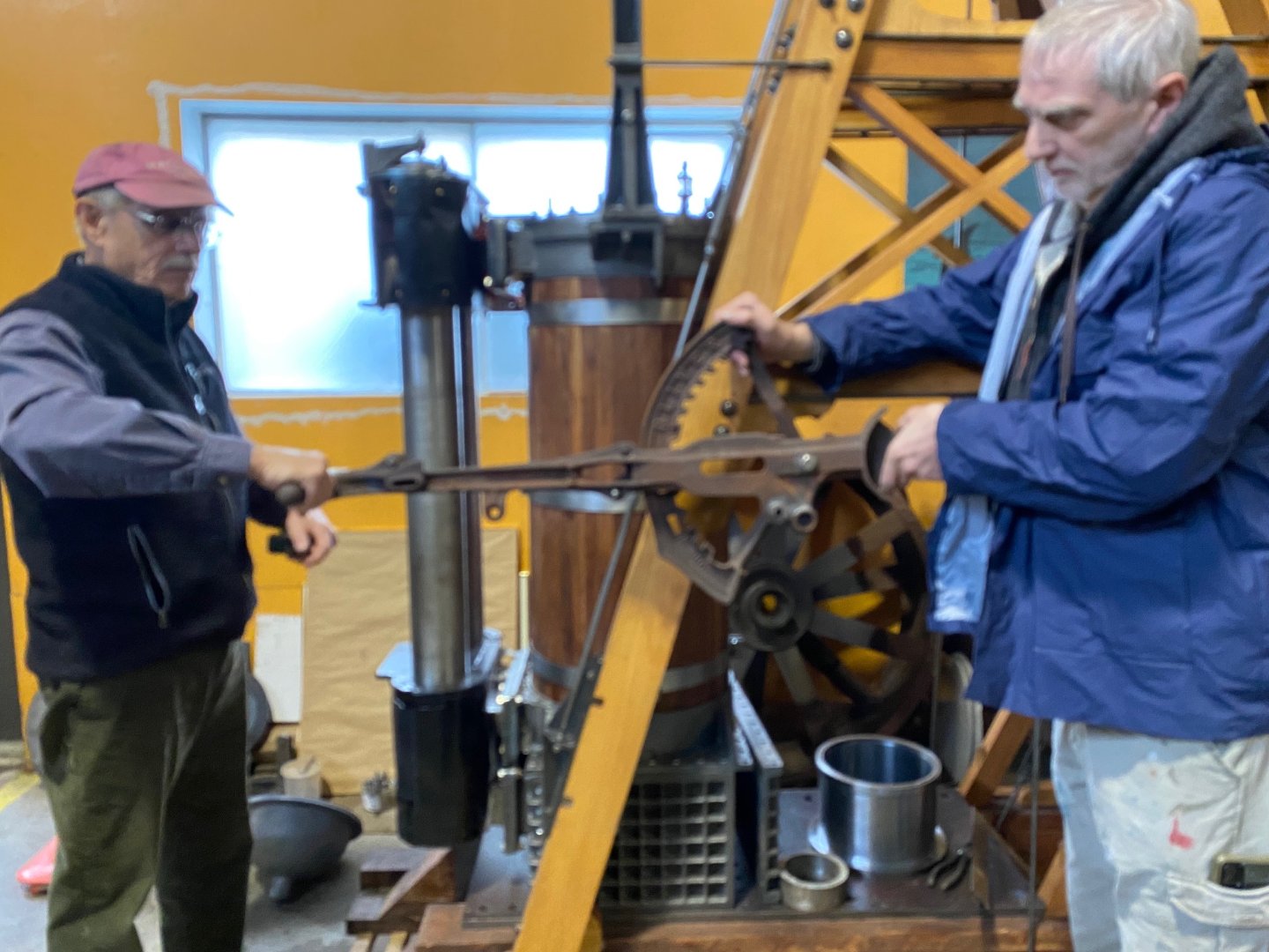

Work on this big (13 x 27 Bore & Stroke) engine continues. We found heavy mechanical tubing, and Chris machined the main valve columns without outside contracting. Plenty of chips! Chris has made patterns and contracted many cast iron parts, photos show eccentric (8 inch diameter), air pump in progress, plus a photo of Chris & Mark thinking about adapting an old farm implement lever to set the engine's valve gear, forward/reverse and cutoff positions.
