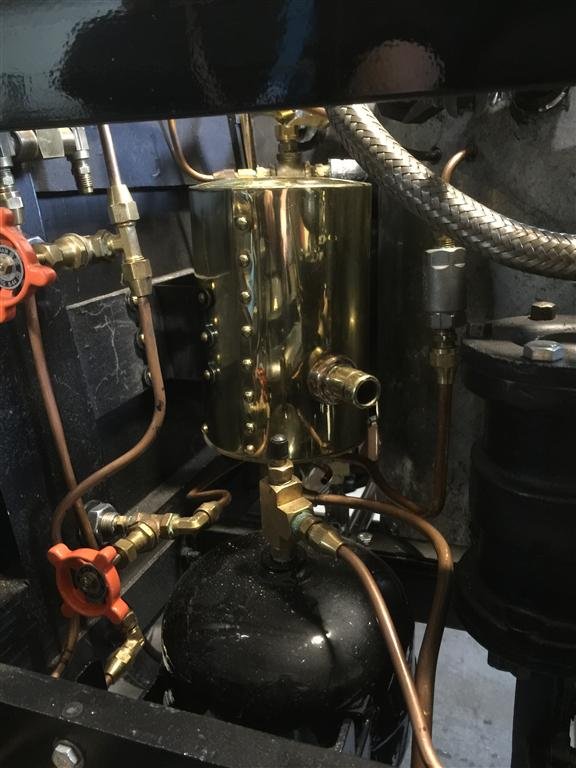

Fred, this is the muffler/feedwater heater I built for an early steam carriage I'm restoring.
- IMG_0901 (Medium).JPG (74.06 KiB) Viewed 69377 times
- IMG_0888 (Medium).JPG (95.2 KiB) Viewed 69377 times
- IMG_0883 (Medium).JPG (147.54 KiB) Viewed 69377 times
