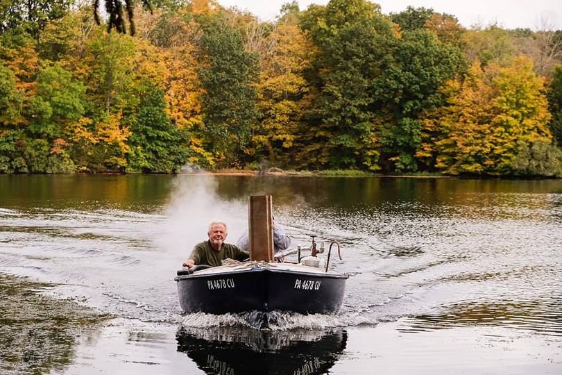

Monotube named Mara, sorted out fairly well for the October Meet.
Made 7 MPH with the oil burner nozzle of 1.5 US Gallons per hour, 150 PSIG Steam.
Next step, increase to 3 GPH, up the pressure to 250 PSIG

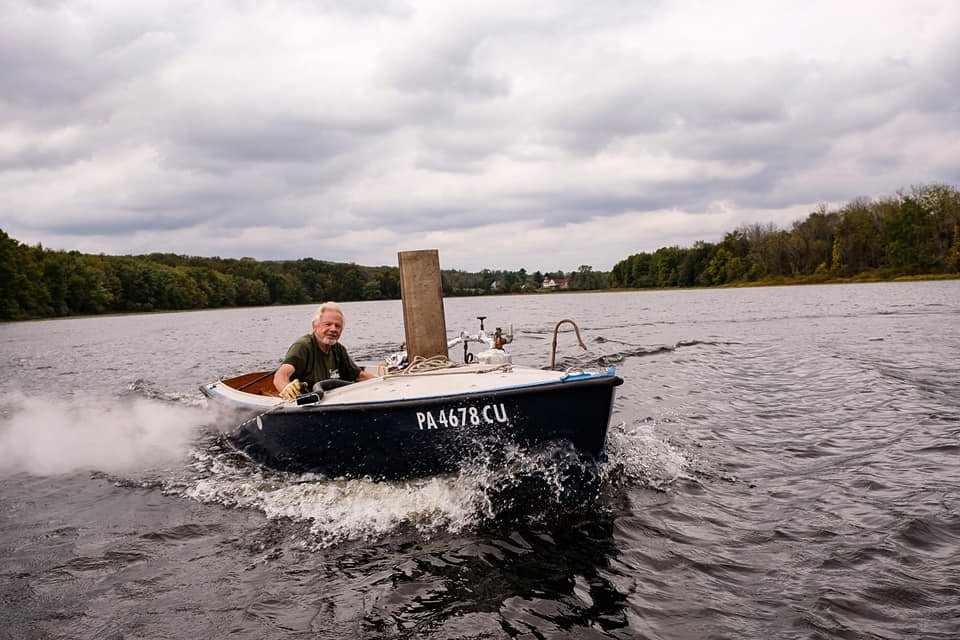

Re: Monotube Javelin
Coming in for lunch
- Mara Coming In.jpg (135.08 KiB) Viewed 140007 times
