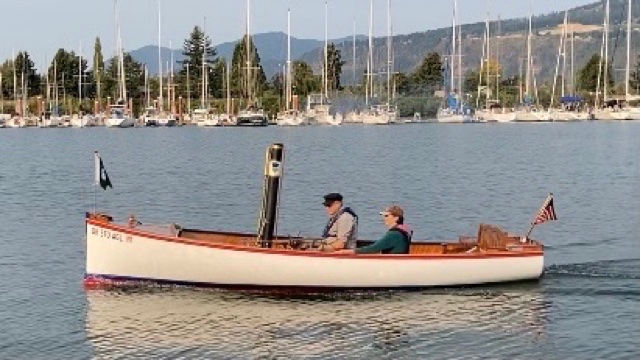

Monotube named Mara, sorted out fairly well for the October Meet.
Made 7 MPH with the oil burner nozzle of 1.5 US Gallons per hour, 150 PSIG Steam.
Next step, increase to 3 GPH, up the pressure to 250 PSIG

Coming in for lunch

Sure looks good.
And makes me anxious to get my Steam Thistle on the waters again. She's not yet fully "sorted out."
