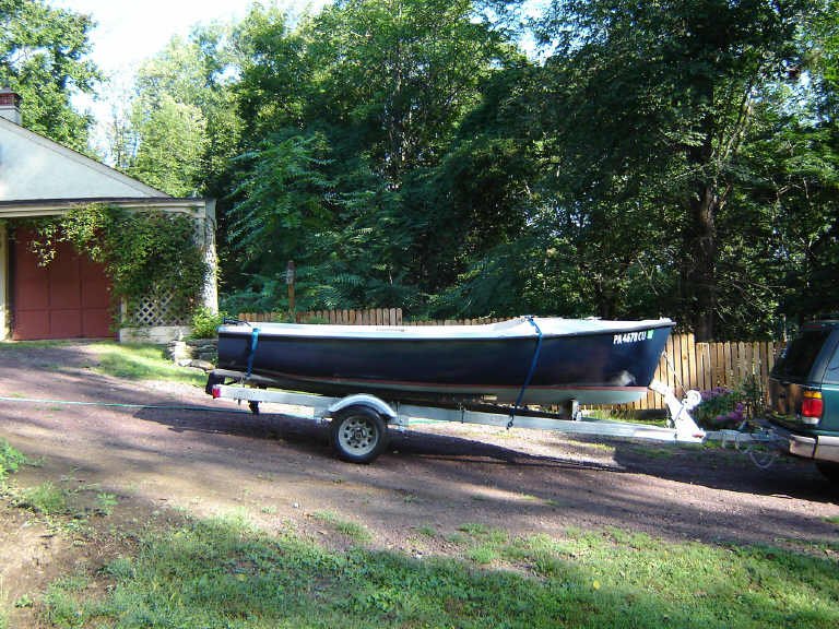

So there you have it, $107 cost on ebay, converted to a propeller drive boat with well under 2 weeks spare time work, with two cans of Krylon spray paint, still excellent after 17 years.
