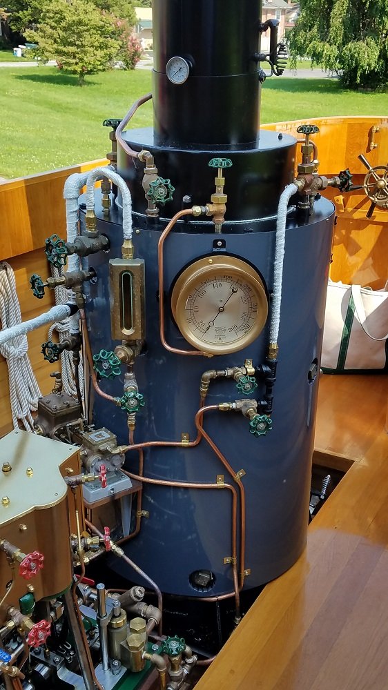

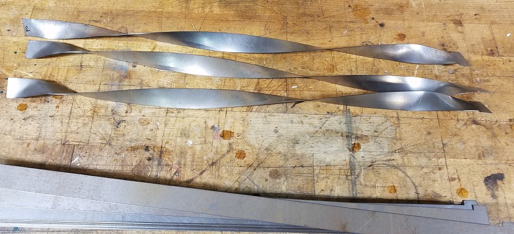

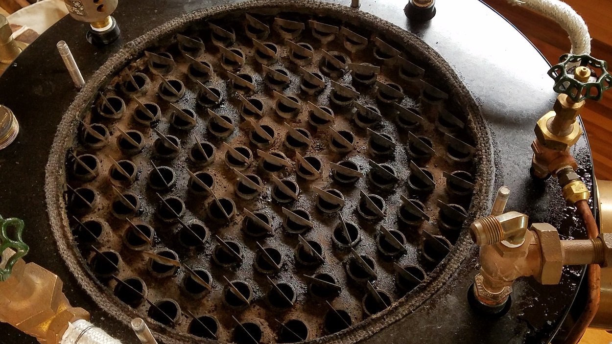

My boiler is based on Mike Condax's tall furnace/short tube design, however, where Mike used sixty one 1.25 o.d. tubes, I used ninety one 1" o.d. tubes with retarders, and have never looked back. She has more heating surface, runs with a lower stack temperature, and makes very little smoke. The retarders make for very steady steaming.
When is is time to clean the tubes, I just reach in the stack hole, give each retarder a twist, and it augers the soot out of the tube to fall on the grate. Takes about five minutes to do the whole set.

your boiler and engineering spaces look very tidy and well thought-out. I like the concept of a shorter and more squat firetube with shorter tubes and larger firebox. The next best thing to a Kingdon style submerged-tube VFT.
It looks as though you could almost clamp each one of your turbulators in an electric drill chuck with some finagling and power scour lol. How close is the tolerance in your tubes between tube wall and turbulator? I like your idea of individual turbulators for the scouring process. On "George H. Sandin" we had them in rows on stainless rods to ease installation and removal. Steam lancing during the season and final brushing at the end of the season (oil fired).

TahoeSteam wrote: Fri Oct 15, 2021 9:24 pm How close is the tolerance in your tubes between tube wall and turbulator?
The retarders are laser cut by a local shop and measure .050 smaller than the i.d. of the tubes. When new retarders are manually twisted. they seldom stay straight lengthwise, so when installed in the tubes they quite often scrape the tube wall on one side or the other for most of their length.
