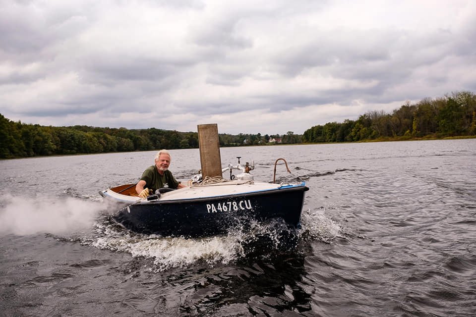

The Margaret S steamboat hull is very similar to the Shelway Fisher Sapphire. 19ft-3in x 60in for Margaret S vs 19'-1" x 59in for the Sapphire. A rather narrow beam allows somewhat better speed than many wide beam type boats. I will share these plans if you like. As far as building, with a full time day job, a friend and I built the hull in about 6 weeks, 1/2 marine ply sides, 5/8 marine ply bottom, all fiberglass and epoxy covered, and metal hull construction could be used. The steam plant took far longer to build.
I have also converted fiberglass sailboat hulls to steamers. Cut out the centerboard well, fiberglass in a shaft tube made from PVC pipe, and there you have a hull ready for the steam plant. About 40 hours work and a few hundred dollars all-in cost to get a fiberglass sailboat hull ready for a steam plant. Last summer I put a rather large steam plant into an O'day Javelin planing sailboat hull, The Javelin is small at 14 feet length, and some other fast sailboat hulls would be better.
I have considered the
O'Day Daysailer quite ideal (17 ft), with 12,000 hulls built. Other options include:
The Thistle, 17 feet. look up an excellent conversion on this forum, about 4000 hulls built.
Flying Scott, 19 feet, 6000 built
Lightning, 19 feet, over 15000 built, a fast hull with plenty of room for a larger steam plant. I wish I had bought one of these that was available, with a broken mast and a good trailer for $250 a few years ago.
