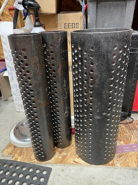

marinesteam wrote: Wed Jun 22, 2022 3:49 pmUsed every bit of the vertical, even with the 4" riser" for the reamer to clear the tube.
So nice to have access to the machine tools at work...
small IMG_20131117_105538_469.jpg (133.62 KiB) Viewed 52362 times

Kelly Anderson wrote: Fri Jul 01, 2022 2:22 pm
Yes, it is.
Nice setup. Looks like all of the rods were used from step block set and a bit or organic material thrown in for good measure!!!!

Added a bunch of air to two 4" tubes to make a pair of mud drums. Next comes comes some tube bending.
