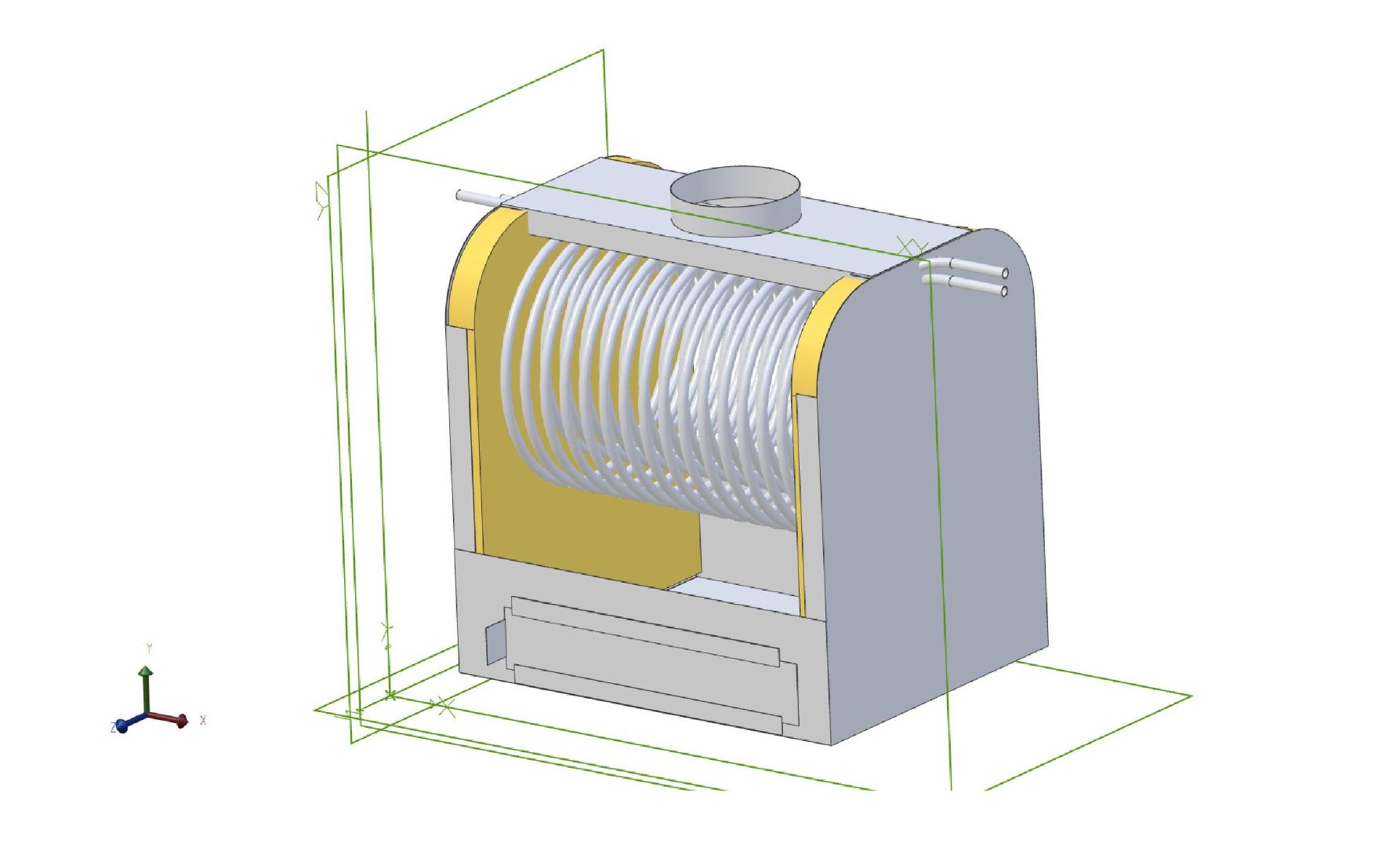

Going back to Fred's questions about the boiler, I don't have more answers yet but here is the CAD picture to date:

The Herreshoff system was used on fairly good size power plants; this meant that condensation losses were significantly less. Example 6x10.5x10, with boiler tubing at 2" diameter.
