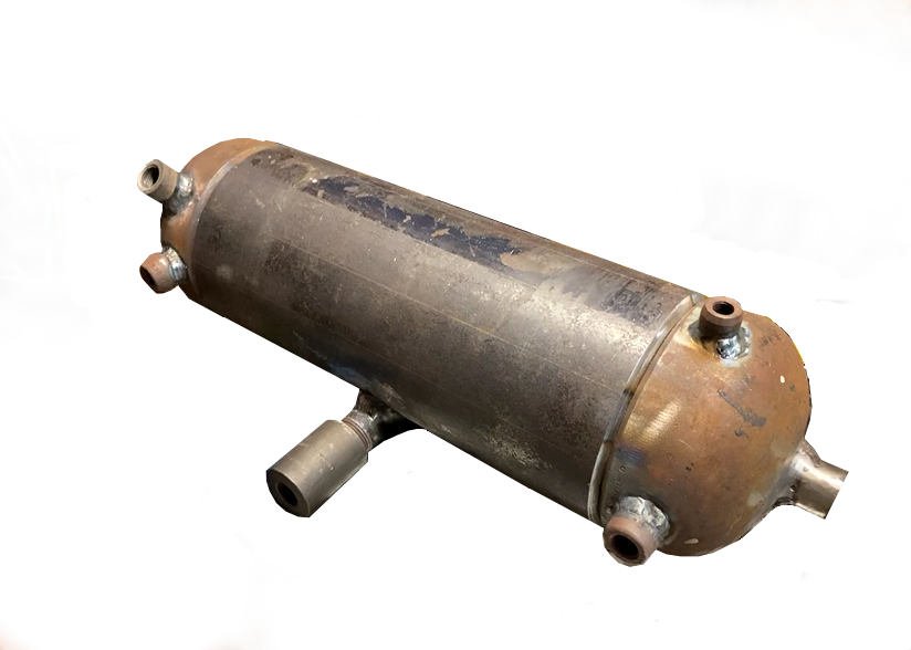

5. The two-phase mixture then enters the separator vessel, saturated steam flows upward and enters the main steam pipe, flows thru the engine and produces power, then exhausts to atmosphere.
6. The separated water falls to the bottom of the separator, where it flows thru the "letdown" outlet. This 365F hot water then flows thru the counterflow heat exchanger, and heats the incoming pumped feedwater. The letdown flow is cooled to about 100F, and discharged overboard. The letdown flow is manually controlled with Swagelok needle valves.
7. A thermodynamic steam trap is also connected to the separator vessel, at a slightly higher elevation than the letdown connection. This assures that the separator vessel will not become flooded if letdown flow is not enough.

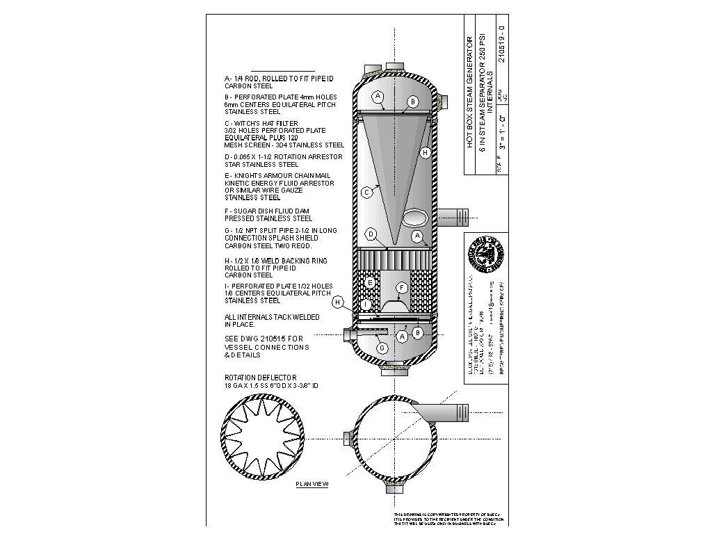

The steam/water mixture enters the separator at about 100 MPH, and that level of turbulence can significantly impede proper separation of the steam and water. This requires separator internals that can properly quell the violent turbulence here, keep water out of the steam outlet pipe, withstand the pressure spikes, resist the significant forces involved, and assure a reasonable maintenance of a water level in the bottom of the separator vessel for the letdown and trap connections.

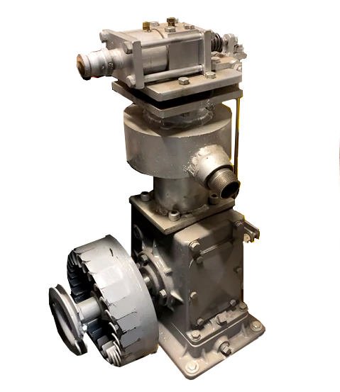

350cc uniflow steam engine that powered my house, with exhaust steam heating my house, for several years in the 1980's. Now with a temporary home in the small steamer.

Drawing of separator vessel internals

Separator Vessel being fabricated, berore final seam welding.
