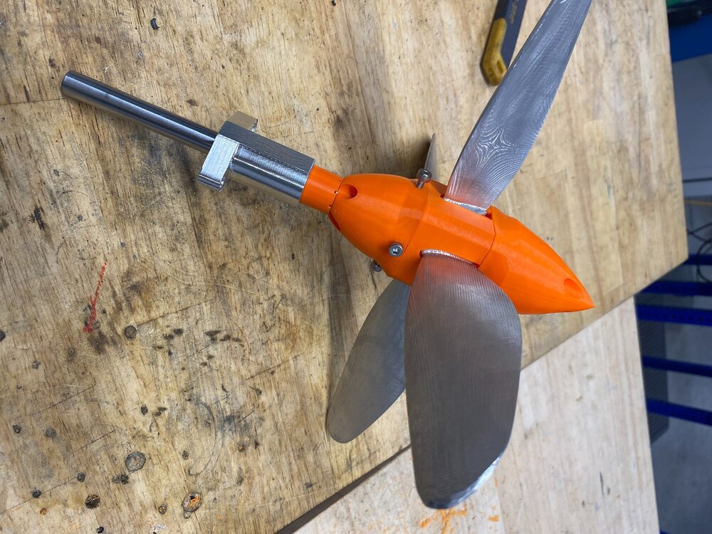

It's starting to look more like a boat. And the propeller is starting to look more like a proper propeller, or propereller.
Yeah, the hub is currently PLA, as I haven't had a chance to machine one out of aluminum yet. It's a pain to drill and tap those angled holes so far deep past the rest of the part, I really only use stub drills and I don't have any extended length taps. On the 2 blade hub I actually drilled and tapped those holes from underneath. However the PLA should hold up to the low forces (<50lbf 300rpm) anyways, especially since the forces work to push the blade mounting points into the hub. If it was machined plastic I would trust it 100% after all at these forces.

I hated that propeller hub so I made a smaller one. Also I have everything together now, except for a longer stainless steel shaft which should be arriving today. Other than that it's time to get all the stainless steel bolts and such for putting the seats and such on the boat.
Unlike those fancy folks on youtube who have racks of filament colors and change rolls every print to make every part a different color, I buy a spool, print the spool, then buy another spool. It's halloween season, so today's color is orange.

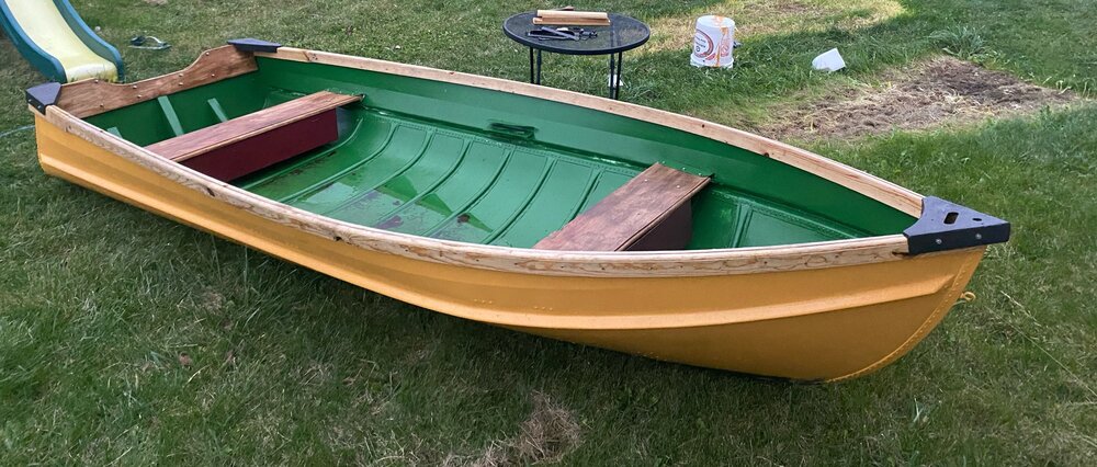

Oh, and since progress on the big boat was stalled, I got bored and started playing around with a small dinghy I had laying around. I built this as a sailboat last year but didn't finish it in time to try it out. Since my engine and boiler are so modular, it's easy to install and swap out. I may or may not get this out in the water this year. If not, I'll have plenty of time to install the engine in the bigger boat. Either way it's no harm to try, especially since the dinghy fits in the living room to work on.

Slow going on any work that must be done outside, so I made some work that I could do inside. First, it took entirely too long, but I am almost done with restoring the 14ft aluminum v-hull.
IMG_1613 Copy.jpg (133.63 KiB) Viewed 109012 times
It looks really nice. I'm going to spend the winter figuring out how to install the engine and boiler, and probably adding some sort of flat floor.

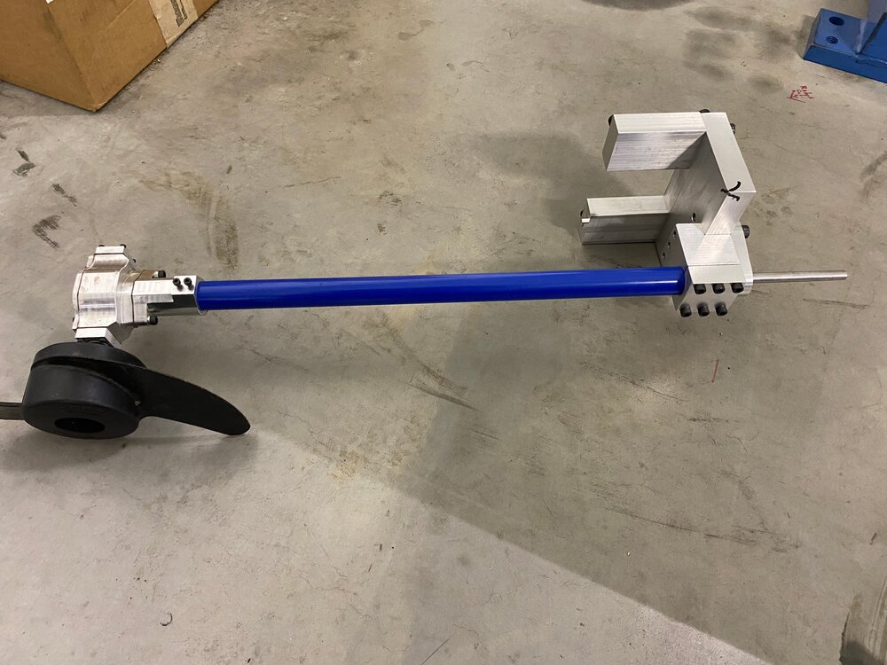

After all the work making a nice propeller and all the jazz, I've decided to go in the outboard direction. I don't want to have to cut a bunch of holes in my boat to install the propeller and mount the engine. Plus my propeller feels a bit fragile.

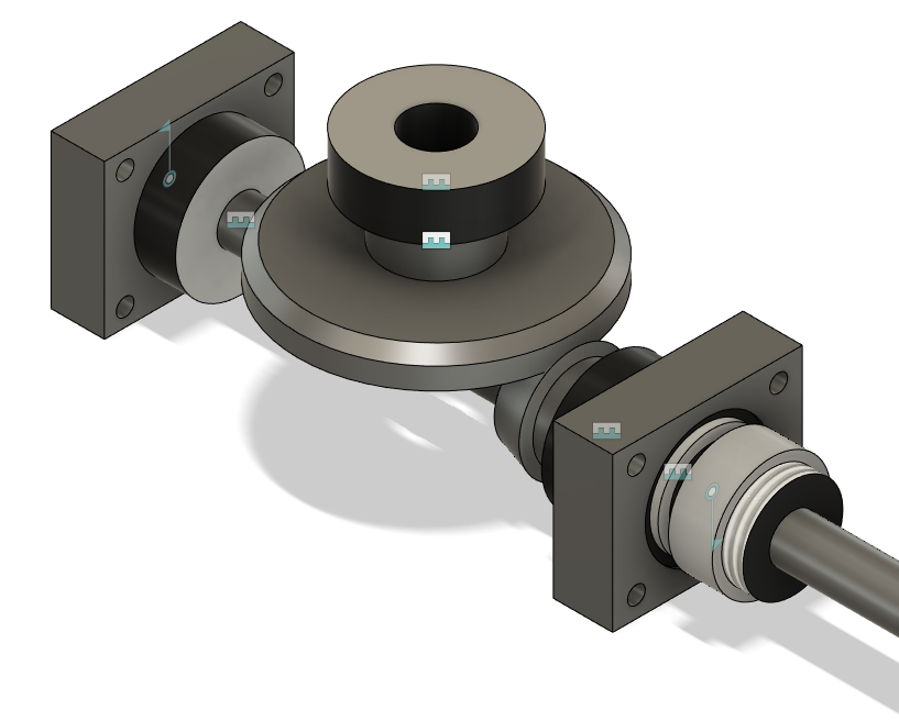

Over the winter I ordered a few sets of angle grinder gears for a pittance from china on a whim, and they sat on my desk for a while for playing with. I finally got some inspiration from them. I'm going to use them to build an outboard that will just mount on the back of my boat. This plus the boiler means that I can easily install and remove the whole setup. The gear ratio of 2.66 also means that I can look at using a purchased propeller, as one gearset brings 300rpm up to 800rpm, and two brings it up to 2100rpm.
This is what I have so far. the gears use 8mm and 10mm shafts, so I ordered a few sets of mechanical shaft seals in those sizes for <$1. I haven't gotten to the propeller or the vertical tube part yet, but I plan on machining this lower gearbox first. The only concern I have with it is that a thrust bearing was an afterthought. I figured I'd let the prop shaft just bear on the front bearing cover, or maybe a steel insert, and just put some grease in there for now. I can always add something else later on the front or rear cover.
I'm also not sure if I should add a shaft seal on the vertical shaft, and then I wouldn't have to worry about making the vertical tube water tight. I think I've decided on having two right angles so the engine can sit upright and not hang sideways all awkwardly though.

I think you're going to want to address that thrust bearing issue. There's a lot of thrust, even on a wee boat... Especially focused on the end of a 12mm shaft. Could end up friction welding it to the end cap, or inadvertently drilling a hole in the cap.

Step 2: Draw the rest of the owl.
It ended up being much simpler than I thought it would once I made some design compromises. The engine will be mounted with the crankshaft vertical, and connected using a chain. Also I decided it wasn't worth trying to seal the vertical tube, so I added another mechanical seal on the vertical input on the gearbox. With the gears, bearings, and two mechanical seals, there's more friction than I was hoping for, but it should still work.
Oh, and there's no steering mechanism, I figured I'd make sure it worked and then add a rudder or something. I also have a hydrodynamic shroud designed that just needs to be printed and installed. I've got a ball thrust bearing laying around somewhere I need to find and install still as well.
Oh, and I couldn't figure out a good built in clamping design, so I'm just gonna use a couple c-clamps for now. With the engine attached it's going to be heaviest on the inside of the boat, so that shouldn't be an issue as far as a loose clamp goes.
