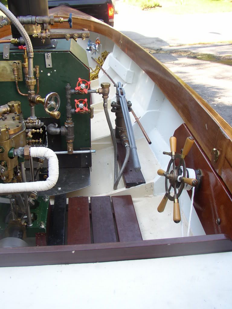

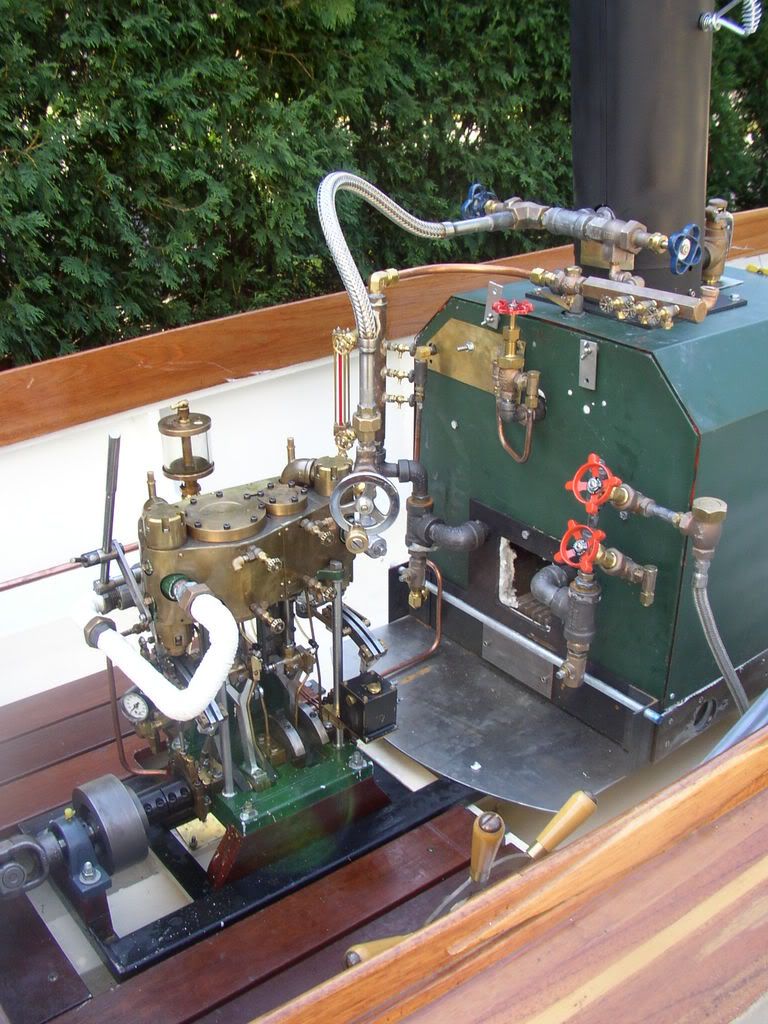

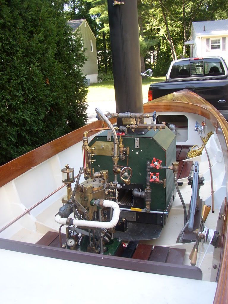

mcandrew1894 wrote:Dave That's an interesting set-up for the sight glass and the three drains in the boiler. Do you have a better photo of it? I've always wanted to have something like that up front so I wouldn't be stuck back with the engine all the time.I think something like the might do the trick. Do you think the captain might even let the engineer steer the boat? Den
If you look at the pictures in the links, its a water column. Those are trycocks, but I think you knew that. 8-) As you can see, the column is turned and faces the engineers position on the starboard side...by the wheel..as well as all the other controls.
Sorry for the highjack...please proceed....
Dave

Re: Building a new boat {OK dreaming about it!!]
Post by 87gn@tahoe »
How is the stability of the water in the glass?
I would think that being uninsulated, your column would act as a downcomer of sorts.
mcandrew1894
Posts: 193
Post by mcandrew1894 »
It does a bit. I am in the process of insulating the pipes, now that the layout has somewhat solidified.
As long as my feed is hot, the level is pretty stable. If I pump cold water in with the hand pump....the level will drop right out of sight. Swell and shrink....but that has to be expected with this boiler....I think the water level is more stable with the water column than without it.
Dave
Dear Den and boating friends
Please keep going and lets see some photos of the chain/belt systems that you have all mentioned. I am planning to follow the same sort of idea that Den proposed, but not to quite such an extreme height. So, I am all agog to see how to do it.
On a related but "off topic" slant, Dave, what is the copper pipe that runs from the steering position to the fore locker and back along the other side of your boat. It looks to end in space or have I missed something? I am also pleased to see how you have rigged you hand pump. That answers the question I have not got around to asking.

mcandrew1894
Posts: 193
Hi Pen,
Sorry for the delay....work is very busy these days.
I use the pipes on both sides to stow stuff. It works well with seat cushions, fire extinquishers, throw rings, ect. The one on the port side ends in space at the rear bench at about station 9. IIRC
The pipe on the Starboard side is also a feed line from the bow tank as well as from over board draw. It is plumbed to take feed water from either via the hand pump and/or the injector. So it does double duty.
The HAND pump hadn't gotten plumbed to the starboard side pipe yet in the photo above.
It has since.
