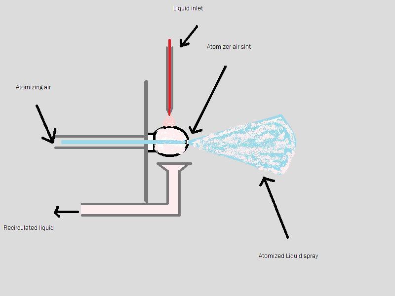

Here is a drawing for a type of burner I used to build a shop heater, I believe they call it a babbington burner. The hole for introduction of the air was .010 if I remember correctly and it operated best at about 30psi air.
[img][/img]
[img][/img]

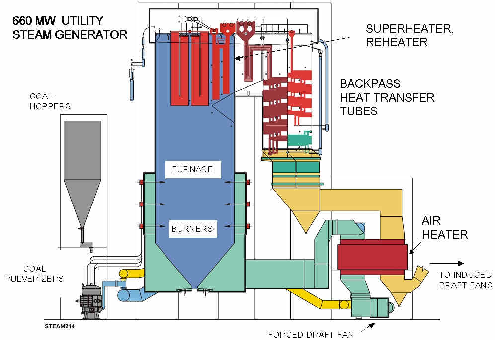

Re: Steam engine fuel efficiency
The short answer to your question: Yes, this can be done.
I teach power plant technologies to engineers at my company, so here is a rather "long winded" answer:
A boiler or other combustion/energy device would theoretically have 100% efficiency if the combustion process is complete (all the fuel burns, ie. reacts with oxygen, releasing the energy), and all of the products of combustion are brought back to the initial temperature of the ambient air and fuel before entering the boiler.
The very high efficiency heating units must bring the temperature of the combustion products (exhaust gas) down to a low temperature, and in the case of Natural Gas Fuel, much of the H2O (Steam/Water) in the products of combustion must be cooled to the point of actually condensing some of the steam into liquid water in the exhaust gas.
When the "stuff" being heated is at a temperature low enough, then the exhaust gasses may be brought to an exit temperature approaching this low temperature, it is just a matter of providing more heat transfer surface area and thus allowing the exhaust gas temperature to "approach" the temperature of the "stuff". This is the method typically used in high efficiency water heaters, warm air furnaces and the like.
If the "stuff" is at a high temperature, for example a boiler operating at 100 PSIG (6.9 BARg) steam pressure, corresponding to a saturation temperature of 338F (170C), some extra tricks are necessary. Conventional heat transfer technology limits the products of combustion exit temperature to something over 338F, which is not low enough to give efficiency in the 95% range.
In order to get the higher efficiency, a combustion air heater attached to the back end of the process is necessary. This device takes in the combustion air (and sometimes fuel gas in a separate stream), and picks up heat from the exhaust gas thru a heat exchanger. This apparatus can, in theory, bring the exhaust gasses down to an exit temperature nearly approaching the temperature of the ambient air that is being used for combustion. As the heated combustion air enters the burner at a higher temperature, the flame temperature experiences a similar temperature increase.
In typical large utility boiler practice, the steam is generated at about 662F (350C) boiling temperature (2400 PSIG -n 165 Bar, Steam), and superheated to 1000F (538C) or more. Feedwater enters the boiler's economizer at about 482F (250C), but the air heater brings the exit combustion products down to about 300F (149C), well below the temperatures of any steam or feedwater within the boiler.
The utilities typically will not bring the exit combustion gas to a lower temperature, although this could easily be accomplished. The reason for this is simple economics (paying for a bigger air heater), plus the fact that utility fuels typically will produce liquid acids if the exhaust gas is brought to a low enough temperature such that condensation is present in the exhaust gas. This would require exotic materials in the air heater, and thus would be way too expensive.

- Utility Boiler, Burns over 300 tons per hour of Coal
- Xxx.jpg (67.03 KiB) Viewed 13297 times
