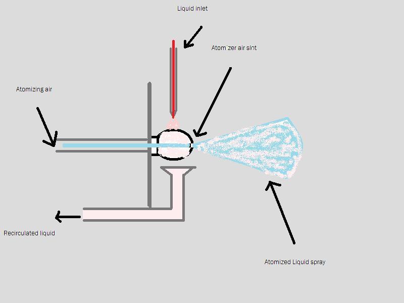

by Aheadslow
Here is a drawing for a type of burner I used to build a shop heater, I believe they call it a babbington burner. The hole for introduction of the air was .010 if I remember correctly and it operated best at about 30psi air.
[img]
[/img]
